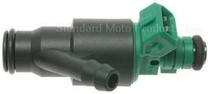

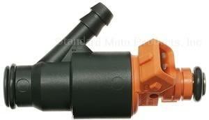

1 2 green
3 4 orange
it is just the physical construction, position of connector relative to fuel inlet
http://i250.photobucket.com/albums/gg246/avigex/injectorGR.jpg
http://i250.photobucket.com/albums/gg246/avigex/injectorOR.jpg

the thing i'm confused about is my 1&2 are orange and 3&4 are green
LMP
03-17-2008, 10:38 AM
as long as electrical connector and fuel hose are connected and it does not impair positioning the injector, I see no problem...
dagan06
03-17-2008, 10:06 PM
spoke to a kia dealer says that it is spose to be 1&2 green and 3&4 orange but sometimes they got instaled different but sould not effect injector performance
