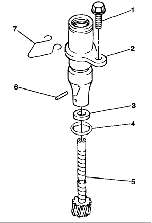

What this means to you is that the failure has to do with the speedometer gear shown below. Remove this piece from the transmission and inspect the nylon gears for wear.

91Caprice9c1,
Great picture. I have done all that you said and here is what I think the problem is... There is a (tube) that fits into the picture that you sent and it has this written on it: "Remco,RECREATIONAL EQUIP. MFG. CORP., OMAHA. NEBRASKA 68127, SPEEDOMETER DISCONNECT, 12VDC ONLY." Everything below it seems to be working fine (all the stuff in your picture). There must be gears or some connection inside this "speedometer disconnect" that is stripped or has gone bad. It doesn't look like there is any way to open it up to inspect or replace damaged parts inside it. Am I right? I guess I have to find a new (or used, in good working condition) "speedometer disconnect." Am I right? Next, where is a good place to find one to replace my bad one? Local parts store said it shows to be a "dealer part."
I'm confused... the end of the speedometer cable is what should fit into the picture above.

When you sent me the "I'm confused," message, I started wondering myself what was this that my car has that others maybe don't have. I web searched REMCO and found out that at one time they had made (10 years ago they quit making it) a device that fits between a transmission and a speedometer cable. It turns off the speedometer/odometer (actually it has a clutch in it that disengages from the speedometer cable when the car is being towed, electrically operated by plugging in the tow cable that also provides power to the taillights) so that when being towed the car being towed wouldn't log any mileage. They stopped making it because it drained the battery of the car being towed because the ignition key had to be turned to the accessory position (and that's another story, now they install battery disconnects). Anyway, the original couple who owned my Metro had towed it behind a motorhome, and had this gadget (speedometerdisconnect) installed. It (10 years later) broke, and just my luck I had no idea what it was or how to get another. I thought it was something all Metros had on them. This is my first Metro. I figured for everything to work properly on my Metro and pass safety inspections, I needed to have it replaced.
All that said, I just went out to the parking lot, no tools necessary, pulled the keeper on it, removed it, pulled the keeper on the speedo cable, shoved it in to the picture you showed me, slid the keeper on and drove it down the parking lot and of course the speedometer/odometer work fine now. The check engine light is still on but I am hoping the onboard computer will reset now that the speedometer is turning.
