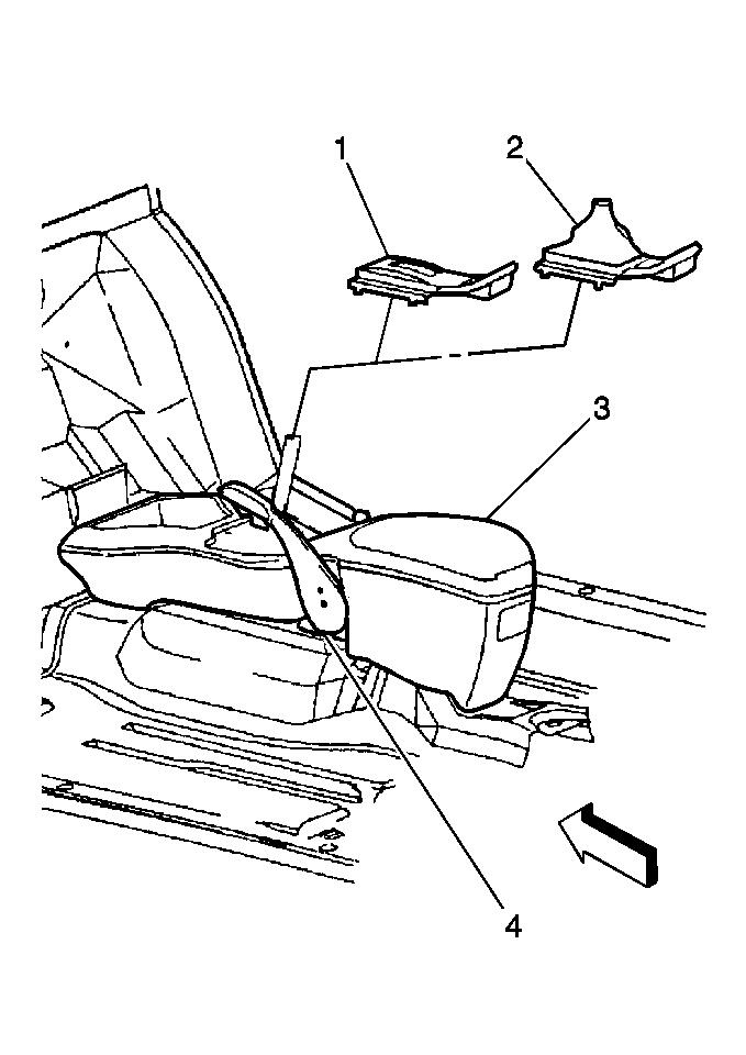

Trim Plate Replacement - Console
Removal Procedure
http://files.automotiveforums.com/uploads/105907trim.jpg
Gently pry upward on one of the following components in order to disengage the retainers: For automatic transmission, the console trim plate (1) and disconnect the lighted shift indictor connector.
For manual transmission, the shift lever boot (2).
Installation Procedure
Align the retainers.
Press one of the following components into place:
For automatic transmission, the shift indicator connector, the console trim plate (1).
Removal Procedure
