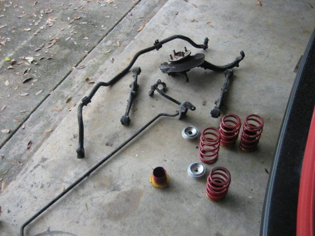

All of the stuff that was set to go into the car today (we only managed time for the springs and lca's before we went for an alignment).
http://i48.photobucket.com/albums/f246/FrodoGT/IMG_2010.jpg

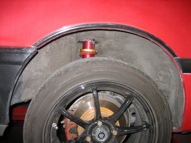

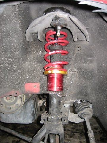

We ended up removing this spring and turning the sleeve to the top of the spring because it fit into the seats much better and made it possible to adjust them with the wheels still on the car.
http://i48.photobucket.com/albums/f246/FrodoGT/IMG_2011.jpg

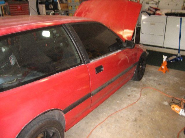

This is with the front done and the rear still untouched.
http://i48.photobucket.com/albums/f246/FrodoGT/IMG_2012.jpg
(the gap was even bigger on the front of the car)

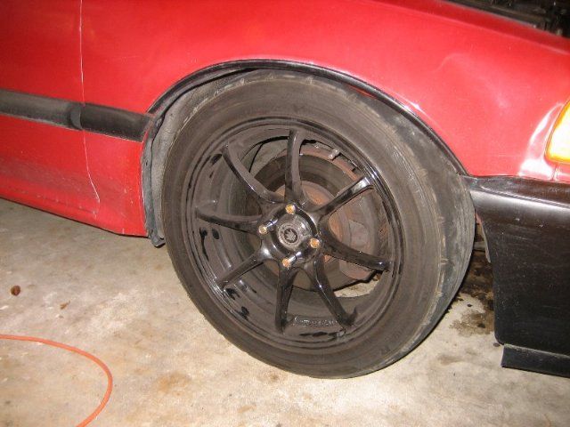

http://i48.photobucket.com/albums/f246/FrodoGT/IMG_2013.jpg
as you can see the gap is, um, a little smaller. It settled once we got to the shop..so it is now officially tucking in the front.

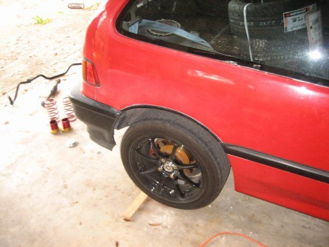

On the rear.
http://i48.photobucket.com/albums/f246/FrodoGT/IMG_2017.jpg

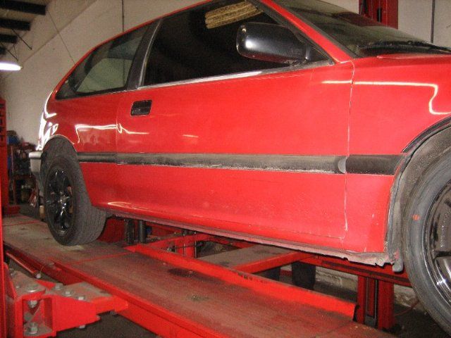

Shot taken before we set off for the alignment rack
http://i48.photobucket.com/albums/f246/FrodoGT/IMG_2016.jpg
