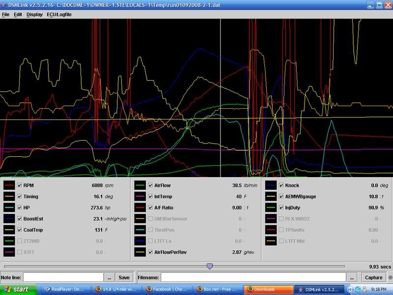

the 14b will not make 30 psi. And I have logs of my Injector duty cycle with 720 cc injectors running at 90%+ on the e316g so I dunno about that one.
steviek
03-04-2008, 09:20 PM
Just to prove
23psi e316g 720 cc's
90.9% IDC
Now tell me what IDC that would be on 450's?
http://i83.photobucket.com/albums/j294/steviekallday/log.jpg
90.9% IDC
