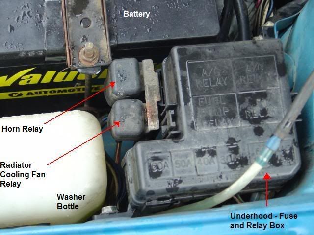

Your Blower motor Does Not operate off a relay, it recieves it's power from either 1 of the resistor value terminals in the blower motor resistor pack or full power (HI Speed) directly from the fan speed switch inside the car. Better go back and look around/under or behind the under hood fuse/relay box for the Cooling fan control relay......The relay your pointing out as the blower relay is the HORN Relay, and is clipped onto the front of the Fuse relay box. The schematic wiring diagram and pic of the relay/fuse box I posted above points this out and shows a "Cooling Fan Relay" in both of them. The relay will have a rubber cover over it and look just like the Horn Relay. BTW, Where was/Is the power wire that they rigged up to power the cooling fan connected at? (On Both Ends).

the photo you provided looks exactly like whats in my car except there is only one relay clipped onto the front of the relay box. the one i have does have a rubber cover over it and when i removed it my inside blower motor didnt work, thats what made me think that that relay worked the blower motor. the wire that is hooked into the fan switch comes from inside under the dash its tapped into the fuse labeled "heater".\
