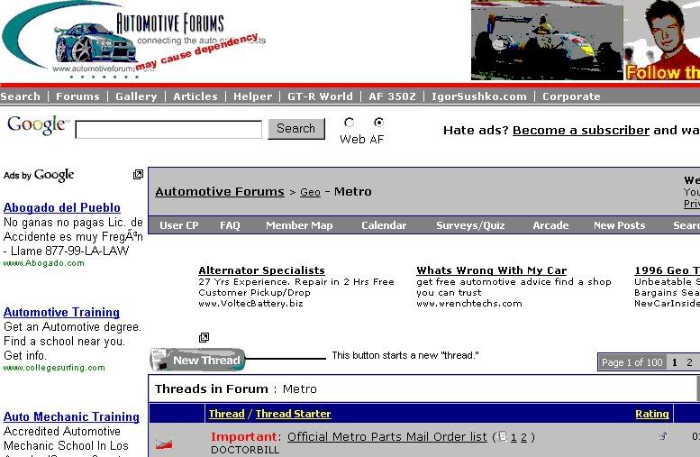

http://i77.photobucket.com/albums/j64/isc20/untitled-2.jpg
-MechanicMatt
In any case...
