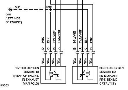

Have a 1997 TP, 3.4l, with 147k miles, but a rebuilt engine with around 40k miles. The SES light is on and AZ's Code Reader gave me 2 codes, P0141 and P0142, Heater oxygen sensor, Bank 1, sensor 2. I'm considering purchasing a new O2 sensor, but they're $70 for a Delco brand. My gas mileage doesn't seem right, it's between 18-19 mpg for city/highway driving. I'm putting the van on the lift this weekend and hope to find a loose wire or something on the downstream sensor. My question: where does the downstream sensor plug in? Is this a difficult thing to replace?
LMP
02-24-2008, 01:09 AM
..after the catalyser
http://i250.photobucket.com/albums/gg246/avigex/HO2S_97.jpg

Thanks, LMP, you always offer your experience whenever someone asks a question, that's great! Unfortunately, I replaced the downstream o2 sensor and no change, went AZ to clear the code, and within 35 miles or so - pop! Came back on. Same code before the clear - could it have been the upstream? Mileage doesn't seem right, 18-19 mpg.

P0141 - Heated Oxygen Sensor (HO2S) Heater Performance Bank 1 Sensor 2
P0142 - Heated Oxygen Sensor (HO2S) Circuit Bank 1 Sensor 3
.... As for mileage, I agree with ventureowner, specially if it is city driving, even in part..but if the code keeps the engine computer in open loop, it may have also an impact...
...notice that 141 is about the O2 heater circuit..check if you have 12V feed at ....pink and black.. of the sensor plug
don't know why they label "sensor 2" and "sensor 3"...?? there are more than 2 dozen codes for O2 sensors, some for bank 1, bank 2....and sensors 1,2,3 in each bank....that is more than we need..:grinyes:
