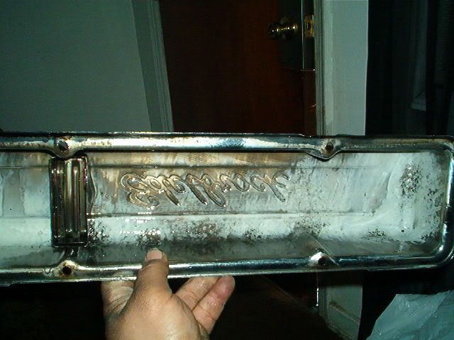

wow guys......i jus may b gettin too much gas....i toook the spark plugs out and they were soaked with gas....i mean soaked.....also....i took off the valve covers.....my oil was milky lookin....but not totally white....i have a pic i took but i have to find my usb cable so i can post the pics off the inside valve cover...

http://i255.photobucket.com/albums/hh121/chevy901/003.jpgthis is the carb i have.its an 65-1850s.where the screw u mentioned? http://i255.photobucket.com/albums/hh121/chevy901/001.jpgthis is my valve cover...the milky lookin stuff i dont like to see..gas n oil?
463
02-19-2008, 11:49 AM
that milky stuff is anti freeze misting up off of the head bolts. if the engine has been worked on some of the old school thinking was to use silicon (rvt) sealer on the head bolts. you can fix this buy removing one head bolt at a time ,clean the head bolt and put pipe sealant ( i used a locktite pipe sealent ) and re torque to the engine specks, Head bolts (sealer on threads).65 ft.-lbs. this will fix this, and a oil & filter change asap after the repair as coolant and bearings do not mix to well. chances are both heads will have to have the new sealant put on and re torque.

02-19-2008, 01:31 PM
head bolts do them one at a time,put the sealant on the clean threads , install and torque. them easy fix. "been there done" that file

Everyone Knows The Problem Im Having And I Tank Everyone For Takin The Time Out To Help...i Noticed Something When I Was Under My Hood.....after Putting My Intake On B4 My Problem Started I Noticed That Alot Of My Intake Bolts R Loose!will This Cause The Problem Im Having As Well....could Antifreeze Leak Under The Intake And Go Into The Oil?and Wut About Gettin In The Runners Of The Intake...will That Cause The Car To Run Good On Moderate Acceleration And Eventually Die After Runnin Idle....so My Question....from The Loose Intake Bolts...can Antifreeze Get Into The Gas As It Goes Into The Piston Chamber And Can It Get Into The Oil That Way?
463
02-23-2008, 04:40 PM
a loose intake = low vac and poor running,oil loss and antifreeze loss. you may get some antifreze into the engine. head bolts are "LEAKING" do them one at a time,put the sealant on the clean threads , install and torque them. easy fix for this problem. "been there done" that file quote"that milky stuff is anti freeze misting up off of the head bolts. if the engine has been worked on some of the old school thinking was to use silicon (rvt) sealer on the head bolts. you can fix this buy removing one head bolt at a time ,clean the head bolt and put pipe sealant ( i used a locktite pipe sealent ) and re torque to the engine specks, Head bolts (sealer on threads).65 ft.-lbs. this will fix this, and a oil & filter change asap after the repair as coolant and bearings do not mix to well. chances are both heads will have to have the new sealant put on and re torque."
463
02-23-2008, 04:58 PM
the coolant in the engine will presure up to apx 16 lbs and without the correct sealant your head bolts that thread into the coolant part (called the water jacket) will mist the antifreeze up the head bolts and fog/mist the inside the valve cover as your photo shows. it becomes a frigen headache to trouble shoot a auto problem when you do not know what the last person screwed up. i have had to start at the front licence plate and go right though the car to the rear plate to make it a good car. 463
