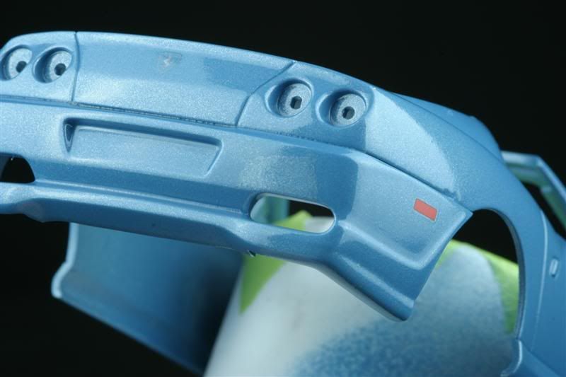

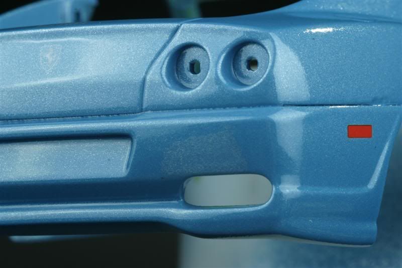

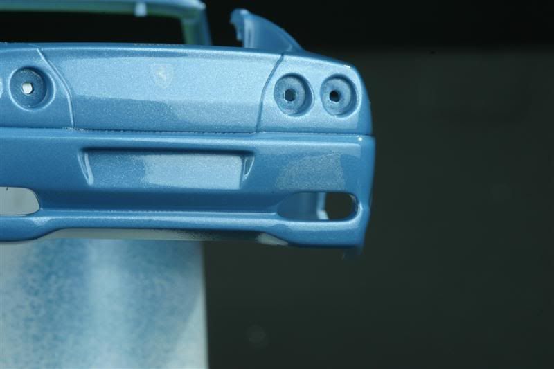

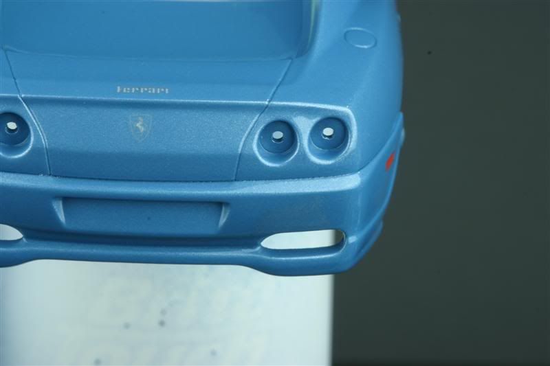

Here are the pics. It's actually difficult to photograph how bad it is. It looks f'ing awful in real life.

That's a shame because it's such a nice paint job as well.It looks like the clear coat may have slightly eaten into the colour coat and taken away some of the pigments,then pooled up and resettled which gives it that patchy appearance.Maybe you could mask and repair and respray the whole rear bumper as Ray suggested.You could make some new decals from plain red decal sheet for the side markers?
