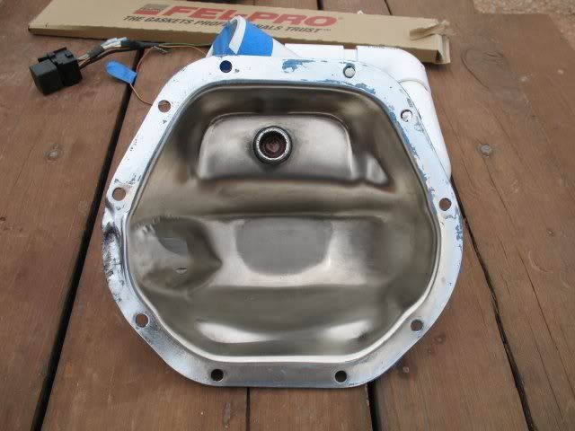

UPDATE 2: just opened up the pumpkin. alot easier than i thought...the oil was very dark gray colored with silver specs in it. i almost wanna think someone added that no leak crap...but no large metal pieces. the gears actually look good. i'm gonna let the oil drain for 24 hrs to get it all out before adding new.
also, i found where it could have been leaking. there's another seal where the drive shaft meets the pumpkin. thats where its leaking. Pinion seal?....:banghead:

Gizmo42
02-19-2008, 08:18 PM
Yup thats the pinion seal. Try wiggling the pinion and see if it has any movement, shouldnt feel any. With the noise you are getting it may be possible the pinion bearing is bad or the nut backed off.
Some tiny silver flakes is fairly normal especially if the oil has never been changed and there's alot of miles on it. Before closing it up and refilling, get a couple cans of brake cleaner and spray everything inside really good to clean out all the junk.
Kinda hard to see the shape of the carrier in the pic with all the sludge (and my monitor is kinda dark) but looks like an open carrier, not limited slip.
FL 3.2L
02-19-2008, 09:47 PM
x2
Get it all cleaned out and make sure the mating surfaces are clean. I have a very minor pinion seal leak that dampens the pumpkin, but I've got to imagine it is a tiny bit of lube that gets by it. I'll bet the other leak was the culprit.
