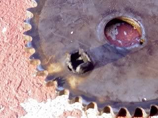

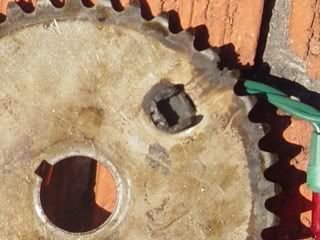

Kristamarie
02-22-2008, 07:34 PM
I got the cam gear, and boy was the interuptor chipped off and in bad shape. I tried to take some pictures in the house but I keep getting a glare when I snapped the picture. I will have to wait until the sun comes up and go outside to get a good shot of the gear.
They also replaced the chain, tensioner (sp.), and a craddle bolt that was almost ready to go, should of kept that too! I have to take her back in the morning to have them clear the codes. One of his techs left the computer connector in another customer's car.
LMP
02-23-2008, 07:48 AM
IF battery was disconnected, all codes are cleared already. Waitin for the pictures. YOur case comes as a definitive hint for those with high mileage 3.8 showing the symptoms you described.

Kristamarie

Kristamarie
02-24-2008, 07:22 PM
http://i250.photobucket.com/albums/gg246/avigex/Camgear2.jpg

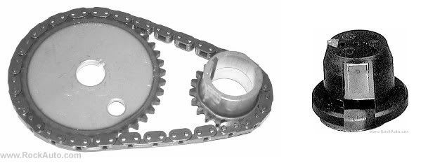

Jrs3800
02-27-2008, 11:44 AM
This is a Common problem with the 88-95 LN3, L67 and L27 Engines... And when you have to go in there its a good idea to replace the associated parts while you are there..
