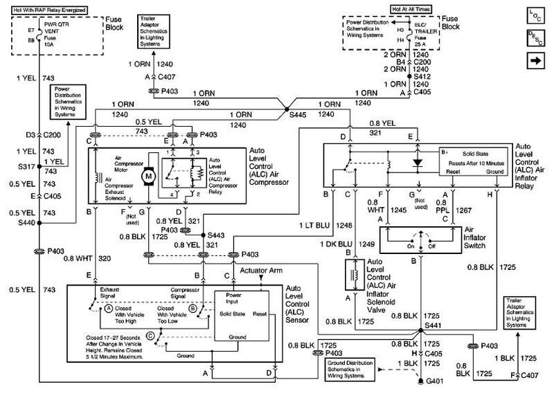

Here is the wiring diagram:
http://i110.photobucket.com/albums/n113/rdh2/00SiloLevelControl.jpg

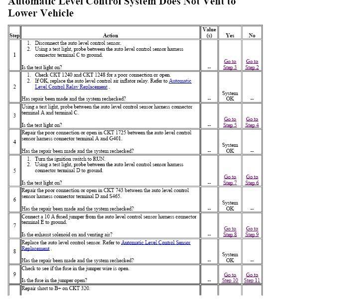

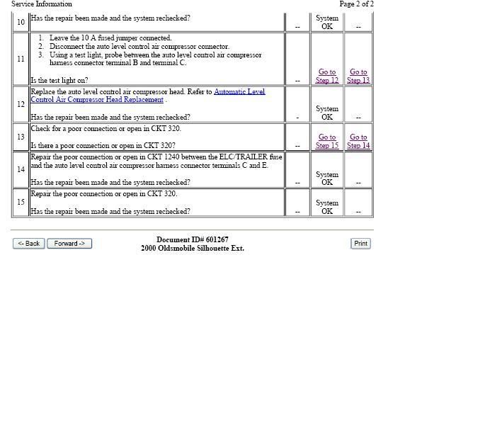

Here is the troubleshooting chart for your problem:
http://i110.photobucket.com/albums/n113/rdh2/ALCNoVent1.jpg
http://i110.photobucket.com/albums/n113/rdh2/ALCNoVent2.jpg
