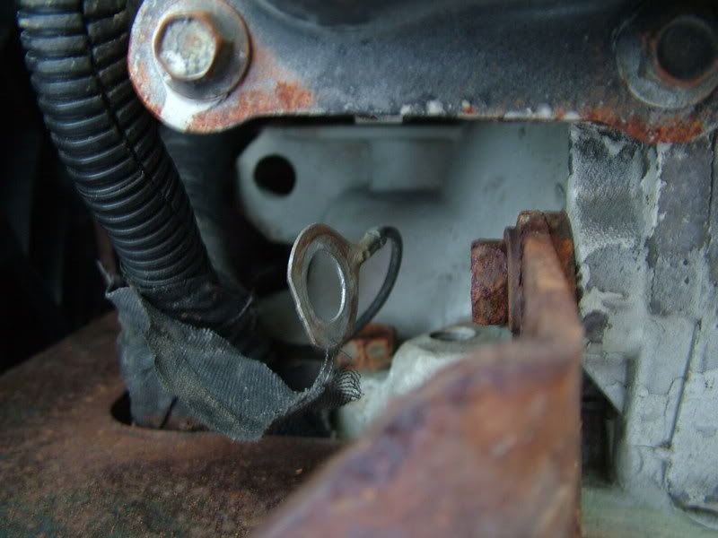

I think I may have found a problem, perhaps the root of this shifting problem. I've read about a transmission (I think) ground by the starter. Its been mentioned rather prominently in other posts. I believe I found it. It wasn't attached under the bolt, but just wedged on top of it, above it in the picture (if I can get the picture into this post), and apparently held there simply by the tension of the wire. In the picture below I moved the grounding ring away from the bolt for clarity.
I'm going to assume that this is a ground wire which should be under a nearby bolt. I'm going to further assume that it is the transmission ground wire.
The transmission was replaced in Maine a year and a half ago. Following that the car was driven very little for the first year because my wife and I were in California. Last Octorer, four months ago, we drove the car from Maine to California, a distance of 3500 miles. All that time the ground wire was apparently held in place by the tension of the wire and the wind pressure of the car as we drove. Does this really seem possible? Are we really that lucky?
I'll try to post a picture here.

If my assumptions are correct, have we done any damage to the transmission? This is of course, a very important question. Is this the root of the problem? But, most importantly, have we damaged the transmission in any way?
Should I simply support the transmission, undo the bolt to the right of the ground ring, install the ground ring on the bolt, and be done with it? Is the fix going to be that simple? How does all this work into the warentee on that transmission? Will it affect the warentee?
http://i82.photobucket.com/albums/j252/4breezes/1995%20Caravan/DSCF5812.jpg

Yes I would remove the bolt clean it up with a wire brush and clean the wire connector and insert bolt thru connector and bolt to transmission. I am not a transmission expert by any means but I would not suspect this would cause damage to transmission. I assume you took pictures of the wire not being attached in the correct manner before moving it for picture on this post. I would think pictures should be sufficent evidence of improper installtion by shop that did the work, IMHO the shop needs to cover damages if any occur to transmission.
