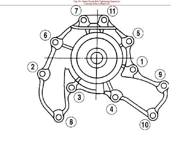

I have read about every post possible on this issue and for the most part I am ready to go and comfortable with what needs to be done. However I have 2 questions that I cannot find answers to and I do not have any shop manuals.
1. What is the torque sequence for the water pump bolts?
2. What are the torque settings for the bolts?

From my Haynes:
1) Tighten all of the bolts a little at a time to the specified torque
2) 156 in-lbs. I know it may sound ridiculous for me to point this out, but it is in-lbs, not ft-lbs.

boritz
02-08-2008, 02:00 AM
Isuzu V6 water pump bolt tightening sequence
http://i190.photobucket.com/albums/z200/boritz_bucket/41A.jpg

oksooner
02-09-2008, 07:18 AM
Perfect!!
Thanks for the info.:biggrin:
