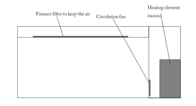

Hey guys,
Well looking for another project to kick around some time. I have been looking at the idea of building a DIY Dehydrator. As many on here i am sick of waiting a week for bodies and days to be able to work on painted or filler parts.
Let me get this straight, Ideally we are looking for a in a dehydrator a small fan for circulation, heating element that is controllable and timmer to control how long its one for.
What my thoughts where was to build a aluminum box around the same size as a bankers box, Split this into 3 portions as the image shows below.
I would have the main drying area where i would have shelves for my models, i would have the top portion for air flow where i would also have a furance filter just to collect any dust that might be in the box and then the third side on the side of the model i would have the heating element so i would be sucking warm air from the element blowing it into the storage area, which the fan in return would suck up and then back in recirculating the air ofcourse drying the models much faster than letting them sit.
My thoughts where to use an old toster oven i have kicking around i was going to remove the heating elements and build a metal box for it i have tested the oven an i can get the little toaster over to hit 85-90 degrees and maintain it pretty consistant. I would also set it up so that the element plugs into a Digital timmer i have which i can set start and stop times, also alows me to punch in a running time so i could punch in 6 hours and hit start and after 6 hours it would just shut down.
the other option i have for possible heating is a spare Aquarium heater - 150 watt keeps my tanks a nice balmy 80 degrees so i do not see why i could not mount it into the box and set the temp i want and then use it plugged into the timmer.. it would be safer i think being a copper heating coil incased in glass as long as i dont smack it with anything it would not cause harm.
My thoughts are to encase the whole inside with insulation foam ( Fire retardant ) with heavy aluminim foil to help retain heat.
Anyone else got ideas? or thoughts on this.

Just one - simply buy a dehydrator for fruits/jerky on eBay for 20$ or so and use the time you save to practice model building skills.
michael lambert
02-06-2008, 11:00 AM
haha,
Cause i can't find a Canadian seller who is selling one, for me to order it through ebay.. I am going to pay $20 for the item, $15-$20 for shipping and then upwards to $30 for Customs and brokerage!
I can build one for $10.. and spend the other $50-60 on kits to practice on :D
not to mention the cheap $20 dollar units dont really hold that much and when i get into teh 1/12 scale cars.. i gotta build one then anyways.

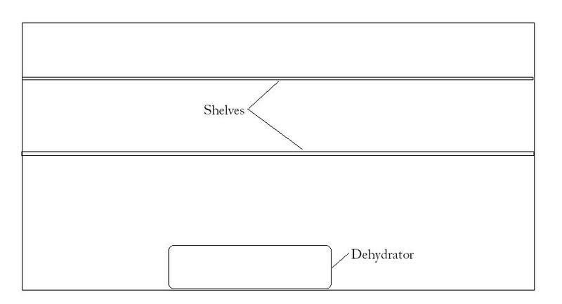

She has put her foot down and refuses to alow me to build something as such.. lol, BUT i found a local Caynes who has THIS (http://www.salton.com/products/?cmd=detail&category=Specialty%20Products&id=11&product=70) model in stock for $40
So i will jump on it, Her concern was the electrical stuff which i could understand where she was coming from.
Only issue with this dehydrator is the shelves are soild and part of the outter frame so i either have to make a new dome and saves these selves for god knows what, or glue all the shelves together and then cut out the centers in orde to be able to lift it off as one peice and fit car bodies in there :D
Might be a silly question, Could i not just take say a larger box idea like i had and just place this dehydrator base in it??? such as this image below.
I can use like a bankers box lined with Foil to keep the warmth in, and just install a couple of windows to see whats going on inside.. makeing a sealed lide for it.. Can anyone see issues with this?
http://img.photobucket.com/albums/v725/Michael_Lambert/Dehydrator2.jpg

I have one with stackable plastic shelves. I cut centers out of the top two shelves and it works fine. Remember not to but a body in your dehydrator with a stand that stresses the body. The heat will warp the body.

Well this bloody thing is really really powerfull!
The only way i can get it with in 110 degrees is to have a 1 inch gap towards the bottom and u cut out a sheild blocking out most of the hot air from raising up.. and this keeps it between 100-110.
