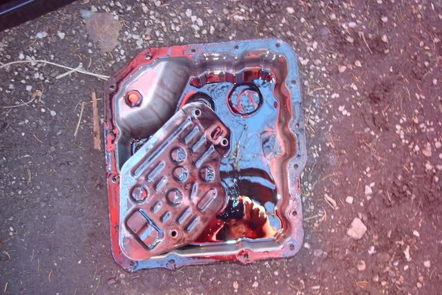

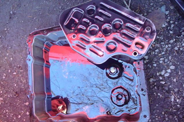

02-15-2008, 11:35 AM
Hi guys,
I change the filter and was very dirty, in the pan was like 1 inch mud , some black oil but very thick. Anyway the truck still don't upshift. The rpm goes 3300 and start sliping. After I almost stop the truck the tranny start have traction again but just around 3300 rpm.
You consider is time for a new tranny or is something I can try?
Thanks. I also have some pictures .I can post them?
Livio

Ramblin Fever
02-15-2008, 01:56 PM
I honestly don't know what else can be tried, but it can't hurt to try something such as Headnsouth mentioned, hard to say if it would help though.....very doubtful.
Word of wise, it's better to find another auto tranny rather then rebuild the one you have....these 4L30-E's are not easy to rebuild and often fail again within a matter of months.
IMHO....tranny's toast.
Keep us posted.
livio
02-15-2008, 02:20 PM
Thank you,
I think I will try AX first.Maybe it will help.
I put around 5 qt ATF you think need more?
Also when I drove it I see the electrical drop from 15 V to 12 V
just around need to shift. Also when is sliping if I put in 2 gear is drive fine bun not in 3 gear.
Also I try it to start in winter mode and doesn't go. Because it start in 3gear?
Seems to be just the 3, 4 and the overdrive?
Maybe a solenoid?
Also when I drop the pan the ATF was almost black . I put almost 8 QT in there. And still black .
In pan I found some very fine metallic particles gold in color.
I think is just shifting very smoot from first in second and just stay there until slip.
I will drive it more and I will keep you posted
Livio
pharm_rodeo
02-15-2008, 03:37 PM
Thank you,
Maybe a solenoid?
Livio
It's time for a new tranny. You can try all the "miracle" fluids you want, but once the components are worn that's it.

Can't wait for the pictures. It sounds like your transmission really suffered due to lack of maintenance.
livio
02-15-2008, 06:11 PM
The pictures, as promised. :smile:
The filter was made in Germany. Is this the original?
http://i262.photobucket.com/albums/ii120/peppercad/2017.jpg
http://i262.photobucket.com/albums/ii120/peppercad/2013.jpg
http://i262.photobucket.com/albums/ii120/peppercad/2014.jpg
Ramblin Fever
02-15-2008, 07:27 PM
All I see is reflection in the pictures....is that because the fluid is chared black??
Not quite sure what you mean about putting almost 8qts of ATF in the pan.
Upon refilling the tranny, 5 qts sounds about right.
The volts WILL drop upon giving the truck gas as you first take off from a stop, it's designed that way.
Some auto tranny's are effected from low voltage from the alternator, but, after hearing/seeing your tranny's condition, it's most likely the transmission itself.
You can keep trying to do more fluid swaps, and additives, etc...but the end result is probably going to be the same, there's no bringing it back to life, not if the fluid is BLACK...sorry but the internals are most likely shot. I don't believe it's just a solenoid.
Personally, I would just leave it alone at this point, and start saving money and researching around for the best deal on a new or rebuilt tranny. OR, take it to a reputable tranny shop and have it looked at for an accurate diagnosis...just NOT AAMCO!
Post more pics if you can...the reflections so bad I can't really tell.
