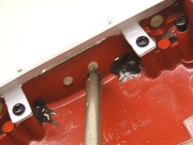

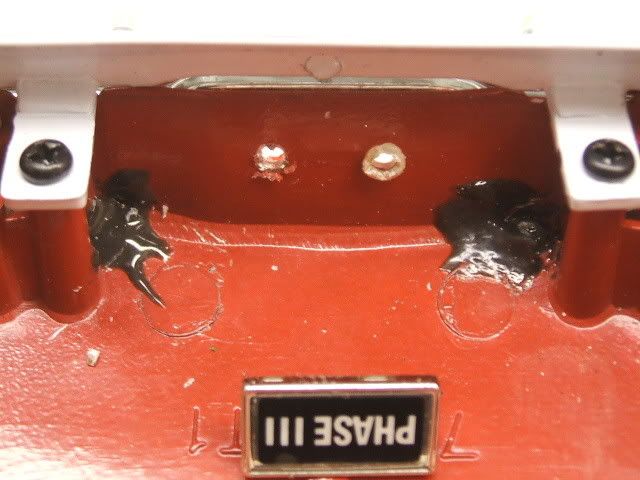

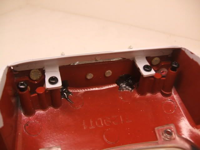

ok this is how you do it...
You have the plastic that comes through on the back
http://i173.photobucket.com/albums/w68/Customdiecastpimp/70%20camaro%20SS/DSCF3560.jpg
Take a screwdriver and push in the middle of the plastic...
http://i173.photobucket.com/albums/w68/Customdiecastpimp/70%20camaro%20SS/DSCF3561.jpg
then it will pop out and look like this...
http://i173.photobucket.com/albums/w68/Customdiecastpimp/70%20camaro%20SS/DSCF3562.jpg
Then you will beable to take it off complelty
http://i173.photobucket.com/albums/w68/Customdiecastpimp/70%20camaro%20SS/DSCF3563.jpg
this is how it looks from the other side..
http://i173.photobucket.com/albums/w68/Customdiecastpimp/70%20camaro%20SS/DSCF3564.jpg
