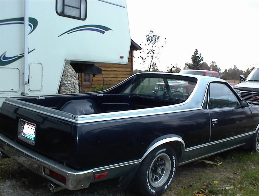

Alright my door will no longer close the latch in the jam seems to move freely unlike the other door were it will latch in place until the handle is pulled to release it. so does this mean that a rod is broke slipped or just maybe frozen anyone with info chim in please this is my only car and the door will not stay closed as of right now so I need help also how do I take off the panel to look into the door so I can check it all out and see what is broke? Can I just pull it off or do I need a panel tool? any help will be great thanks from a new elky owner. Here are some pics of my car.
