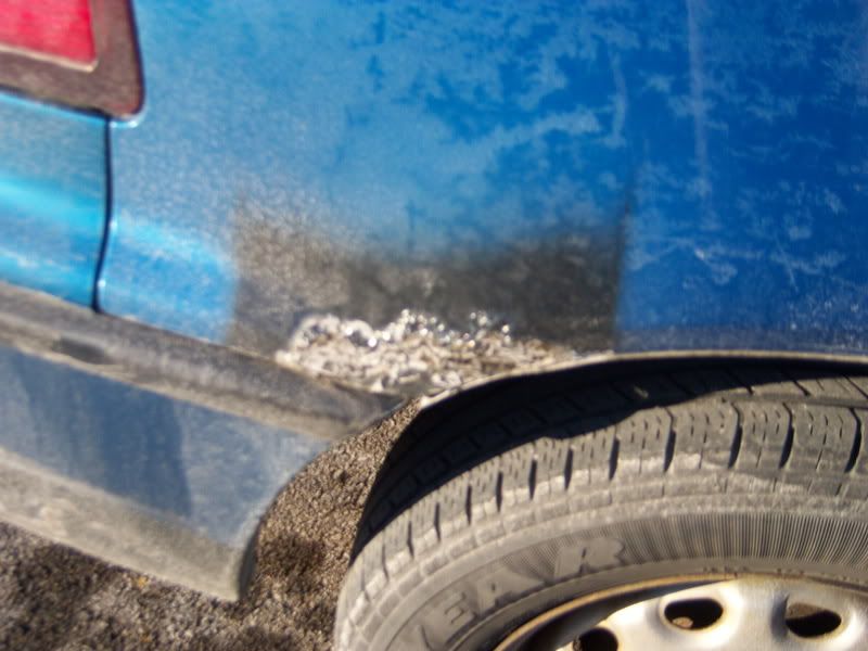

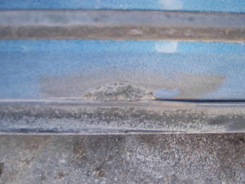

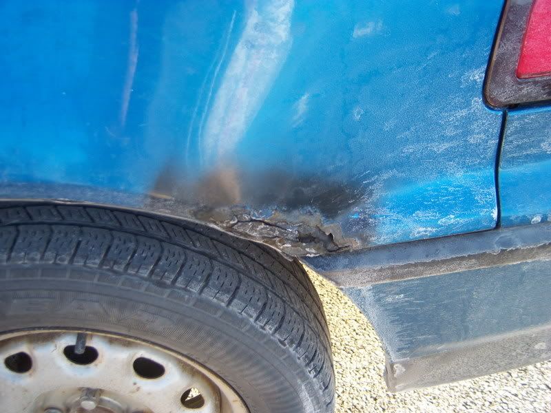

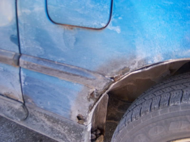

Im posting some pics next, and some shots of the rust. Its gettin pretty cold and shitty here in OH, Im wondering if I should start on some of these spots soon? Any advice?

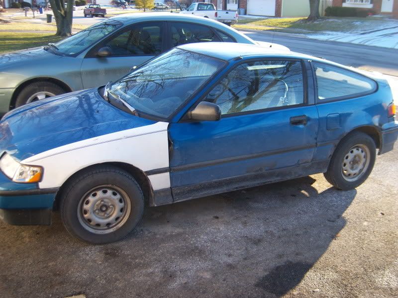

http://i132.photobucket.com/albums/q28/FreshKicks1/100_1052.jpg
http://i132.photobucket.com/albums/q28/FreshKicks1/100_1051.jpg
http://i132.photobucket.com/albums/q28/FreshKicks1/100_1050.jpg
http://i132.photobucket.com/albums/q28/FreshKicks1/100_1049.jpg
http://i132.photobucket.com/albums/q28/FreshKicks1/100_1048.jpg
http://i132.photobucket.com/albums/q28/FreshKicks1/100_1047.jpg
http://i132.photobucket.com/albums/q28/FreshKicks1/100_1046.jpg
http://i132.photobucket.com/albums/q28/FreshKicks1/100_1045.jpg
http://i132.photobucket.com/albums/q28/FreshKicks1/100_1044.jpg
http://i132.photobucket.com/albums/q28/FreshKicks1/100_1043.jpg
http://i132.photobucket.com/albums/q28/FreshKicks1/100_1042.jpg
http://i132.photobucket.com/albums/q28/FreshKicks1/100_1041.jpg
http://i132.photobucket.com/albums/q28/FreshKicks1/100_1040.jpg
http://i132.photobucket.com/albums/q28/FreshKicks1/100_1039.jpg

FrodoGT
01-23-2008, 06:27 PM

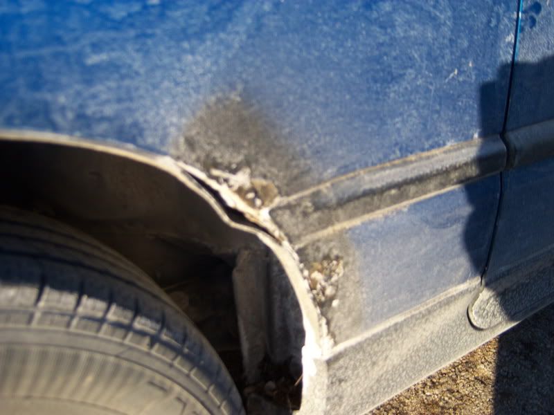

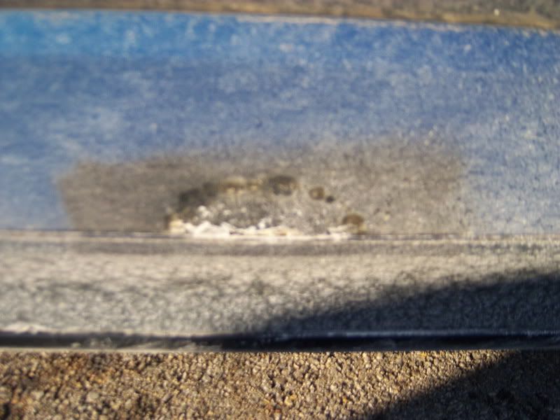

Nice color man, but yeah id start on some of those spots asap, like this spring or summer.

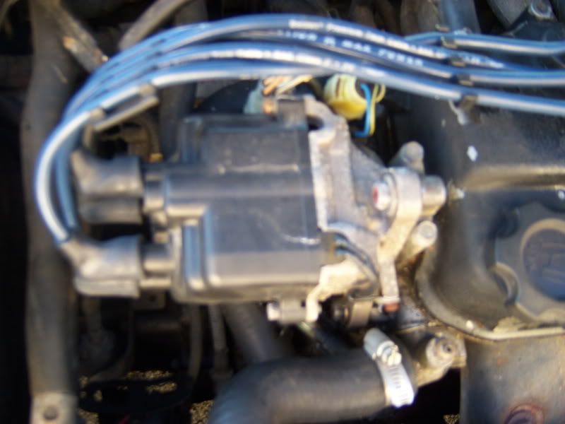

the Si has more powerful spark than the HF. MYTH
The HF and Si use exactly the same parts, including the ignitor, and the spark is identical in either application.

i think i might have an Si dizzy but ill have to check when i go home next..got a busy week ahead..blehh..
