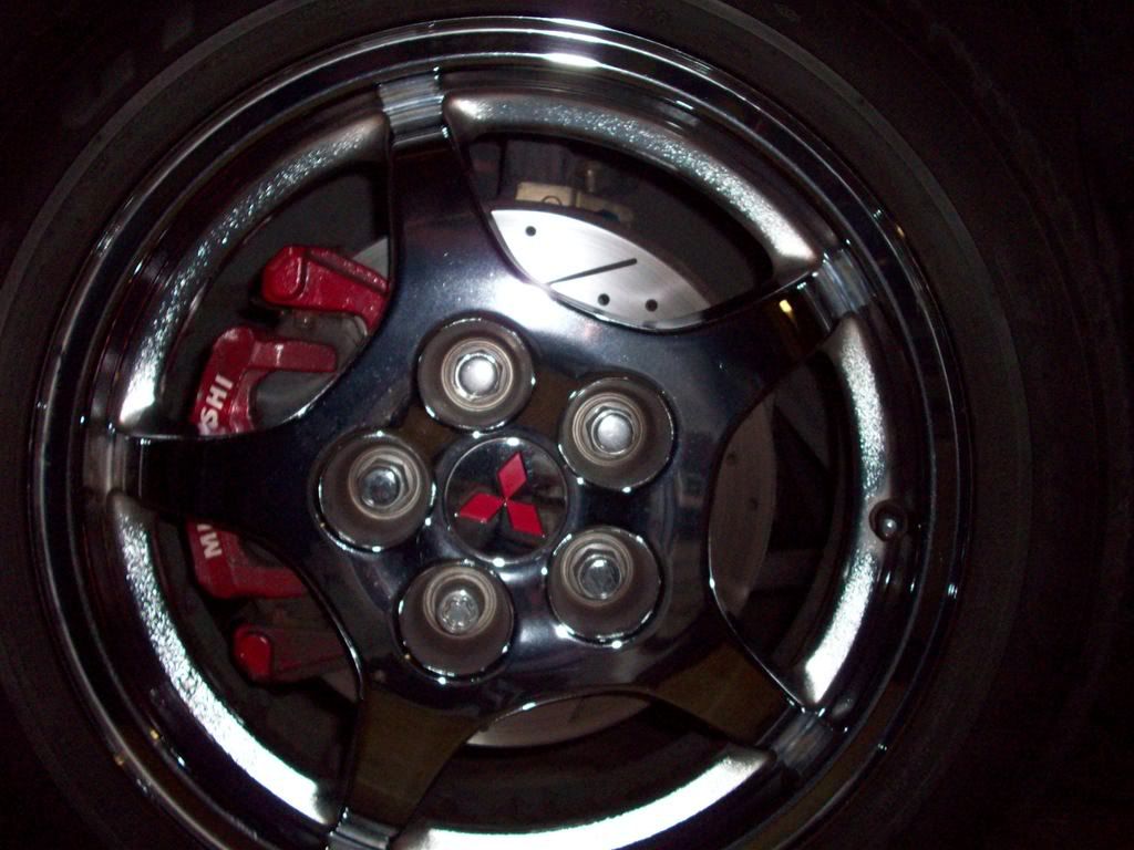

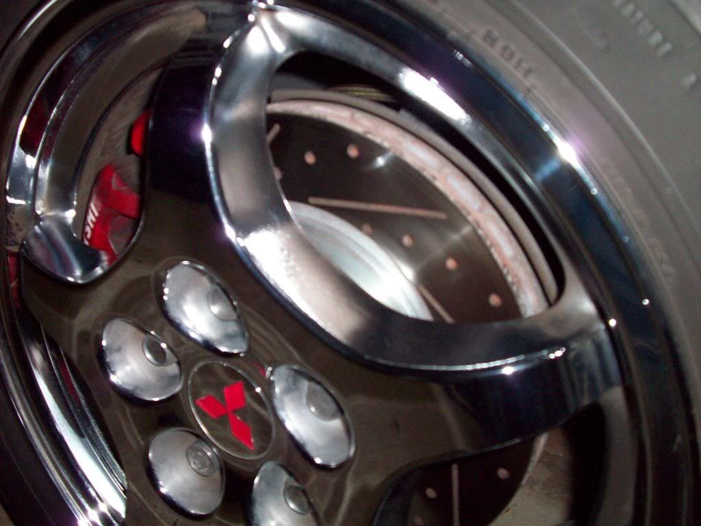

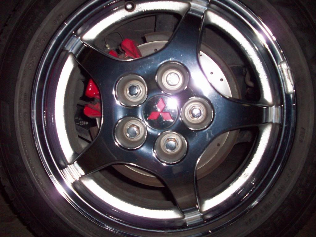

AWD calipers are painted red and branded with mitsubishi i'll get a pic up in a few mins..
EDIT:
PICS: as promised
FRONT:
http://i186.photobucket.com/albums/x104/DSMtuner646/100_0069.jpg
http://i186.photobucket.com/albums/x104/DSMtuner646/100_0067.jpg
http://i186.photobucket.com/albums/x104/DSMtuner646/100_0066.jpg
