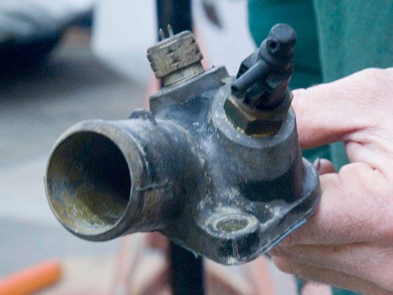

What kind of sensors are these? '87 waterneck

(L-REAR) ECM Temp Sensor and (R-FRONT) a sort of temperature sensitive vacuum valve, I believe for the canister or PCV... one of the two. It's been a while since I've had either on my car.

I'm ditching the ECM so I guess I'll be picking up a neck with no ports on it then. Just been trying to figure out what all needs to be hooked up to get going on this.

the left one is engine temp the right is i believe EGR. when engine cold no EGR valve should open . on temperature rise.......vacuum is allowed to open egr......through this valve......

buy brass water pipe plugs at your local hardware/plumbing store to plug those off
paint it all black
done and cheap and easy
i do this all the time on these
