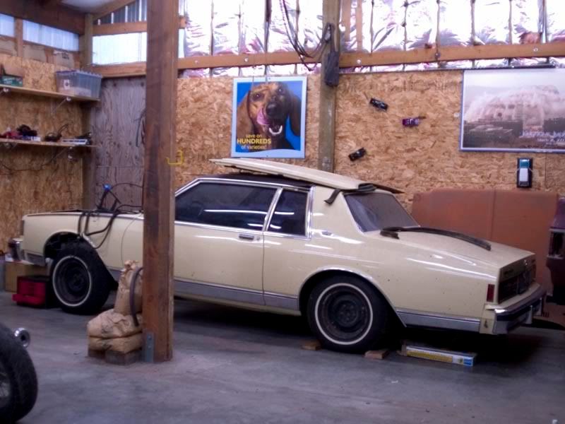

After searching all the header threads in this forum I've come to the conclusion that no one has headers on their box Caprice. But if you do, please reply and let me know exactly what brand and model because I'm having the hardest time finding anything on the web. I've got an '87 minus emissions so I thought I'd have a fairly easy time finding headers for this car--everything else has been easy to find so far.

I got some full length Hedman's. I'll post a photo and info once I make sure they're going to fit and after I install them. I'll wait 'til I get to the exhaust shop to find out if I need to do something different than my stock 700r4 crossmember. Maybe they'll be able to work there exaust pipe bending magic. One concern I had with the dual hump crossmember is that I would need to bash in my floorboards on the drivers side.
What options for crossmembers are there on the 91-96 b-bodies? Did those cars use the 700r4? Will I just need to find a 91-96 b-body with a 700r4 crossmember and I'll be good to go?

So it's looking like these Hedman's are going to fit, but the right side hits the nipple on the front end of the starter so I'm going to pick up a smaller high torque starter.
Also I decided to break in the motor with the stock manifolds on it so I don't ruin the header coating. Then I come to find that the rearmost bolt on the right manifold won't fit with my new Vortec heads. I guess I'll just do without that 1 bolt for the break in.
Is there any reason not to use stock manifolds for break in? Does the difference in back pressure between the stocks and the headers effect cam break in at all?
