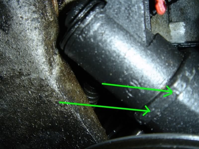

http://i28.photobucket.com/albums/c242/xeroinfinity/Models/ps-pressure_line.jpg
Green arrow is th epressure line and the nut that removes it.
Red arrow doeesnt come off.

oh i wasnt talking about where the red arrow is. at the bottom of that part is where the big bolt is. but anyway i got the EVO components off and transfered them to my new pump and now i still dotn have power steering. i bled the air out and bled the old fluid out. after that it stopped foaming and it didnt whine anymore so i decided to lower it to the ground to try it and theres no power steering. so i think i think the EVO might be broken. ive read another forum and it said that they didnt have power steering also and tey found out the EVO was broken. and yes i made sure it was plugged in haha.

Yeah its pita to remove that sensor.
http://i28.photobucket.com/albums/c242/xeroinfinity/Models/EVO_sensor.jpg
I usually just buy the pump with the evo/vasa sensor and swap the resivour.
Pretty damn pricey either way !
On the bleeding, it can take a long while sometimes. The trick is not letting it foam up. Sythetic PS fluid IMO foams less. Also thier is a proceudre in the Tips & maintenance section. :thumbsup:
And double check the wires on the sensor, they can get damaged. Check for continuity & power w key on.
