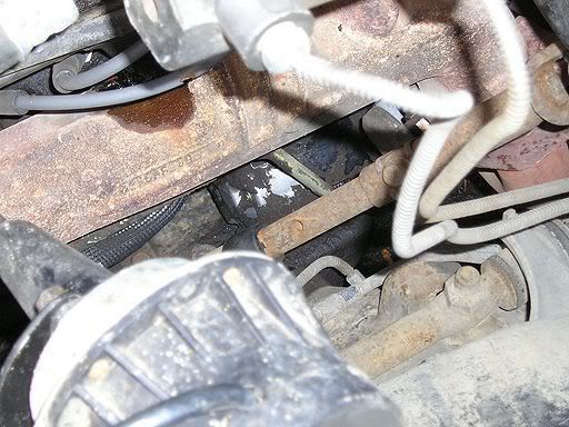

Here's a few pictures. Look at that battery positive terminal!!

http://i160.photobucket.com/albums/t163/holypiston/dakdrvrside1.jpg
http://i160.photobucket.com/albums/t163/holypiston/dakstarter.jpg

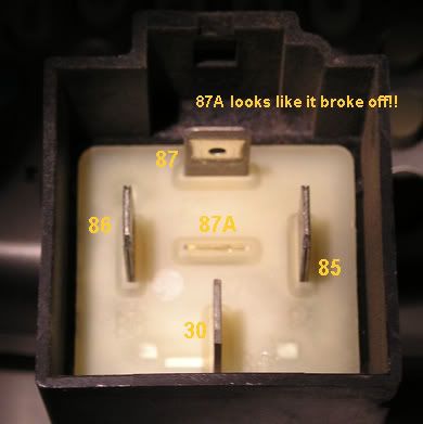

I measured voltage across the battery @ 11.75V. I think i may have found something in the starter relay. Looks like the terminal for 87A has either broke off or maybe they designed it that way for the 1990 Dodge Dakota SE 3.9 L V-6?
Relay terminal test (FLUKE 16 multimeter):
I tested 87A and 30...showed 0.6 ohms resistance, i was expecting 0.2 ohms or less
Between 87 and 30 ....infinite resistance ...that is good.
85 and 86 i show 87.7 ohms resistance and spec is between 70~80 ohms.
I'm gonna buy a new relay and terminal...wish me luck.

Benzman
01-04-2008, 05:38 PM
Use a paperclip to jumper the two connections that measure open (infinity).
That in conjuction with the key turn should cause a start.
