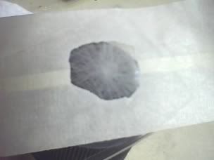

Seriously though. . lol. .

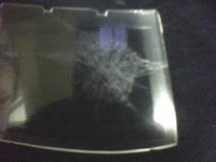

Tear a hole in some masking tape to the approximate size of the area ya want cracked.
http://i73.photobucket.com/albums/i213/Lambo63/1-1.jpg

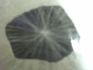

Work your way around with an Exacto blade. Start at either the point of impact and draw the knife lightly out towards the tape edge or make repeated intersecting passes. Remember to take light passes. Your only going for distortion.
http://i73.photobucket.com/albums/i213/Lambo63/3.jpg

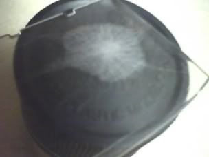

Keep going until the area is covered with web like lines.
http://i73.photobucket.com/albums/i213/Lambo63/4.jpg

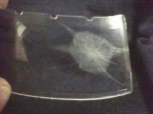

Then remove the tape and add additional spider cracks across the windshield.
http://i73.photobucket.com/albums/i213/Lambo63/5.jpg
http://i73.photobucket.com/albums/i213/Lambo63/7.jpg

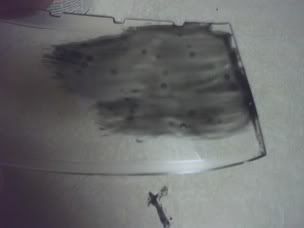

Give it a black wash (I used a combo of Tamiya paint and a black Sharpie).
http://i73.photobucket.com/albums/i213/Lambo63/6.jpg
Then use some fine sanding grits to polish out any roughness followed by a good waxing.
http://i73.photobucket.com/albums/i213/Lambo63/8.jpg
http://i73.photobucket.com/albums/i213/Lambo63/9.jpg
Practice on a scrap windshield or even a clear plastic soda bottle to get the hang of it.
Add more cracks or webbing if needed along with addition black washes. You can also add sags by carefully heating if need be.
