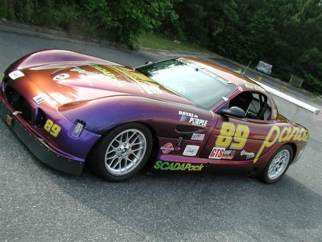

Soflow1
01-04-2008, 10:39 AM
Hey there guys...glad to see these cars being put to good use! I'm one of the former original Panoz GTS owner/drivers from back in 2001 when the Panoz Racing Series was televised by Speedvision.
Speaking of colors mine was the PPG Magenta to Gold Harlequin colored car. It was always a crowd favorite!
http://i66.photobucket.com/albums/h269/Soflow1/StrubPanoz89_1.jpg
I've got a lot of experience with these cars and have driven just about every version made through-out the years. In fact, I've raced Squerly's car several times both in the Panoz Series and SCCA GT2. I won the 2004 Petit Lemans Panoz Series Race in that green car. It's the former PAD (Panoz Auto Development) car, and it had been maintained and setup very well. Back in 2004 I was consistently making high 1:32's and low 1:33's lap times with it at Road Atlanta.
There exists three variety of car. The GT-RA school car with its 5.0 HO engine (250HP), the School Race Car with its 4.6 Cobra engine (345HP), and the 5.8 Ford Powered GTS (430HP). Wheel size, transmission, and gearing were all different pending upon year and model.
Are all the Panoz cars sold? I've heard there is talk of a race series in HSR. Is this a real thing? How many folks are going to race and what version of the car are people going to be racing?
