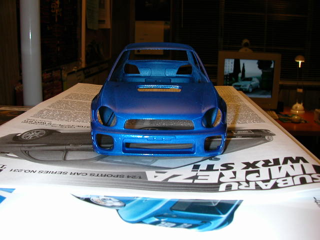

here's pics of my new Taimiya WRX.. should i be worried about the orange peel of the finish??

U should get orange peel if used cheap spray paint or if ur Nozzle is clogged, or another reason is if u dont know how to spray. I had orange peel on my first model cuz i wasnt good at spraying and my next models were perfect.
daggerlee
02-17-2003, 05:05 PM
You ought to clearcoat it for best results.

Clearcoat :)

Worry about it? - No. Consult the PMan painting FAQ? - Yes. There's a ton of ways to address the peel. It's up to you.

isnt it possible to get rid of the orange peel by simply waxing and polishing long enough?? I think i read that in the FAQ..
fullbloodchop01
02-18-2003, 03:08 PM
i think alittle Tamiya Compound should do the trick:cool:

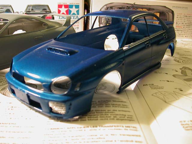

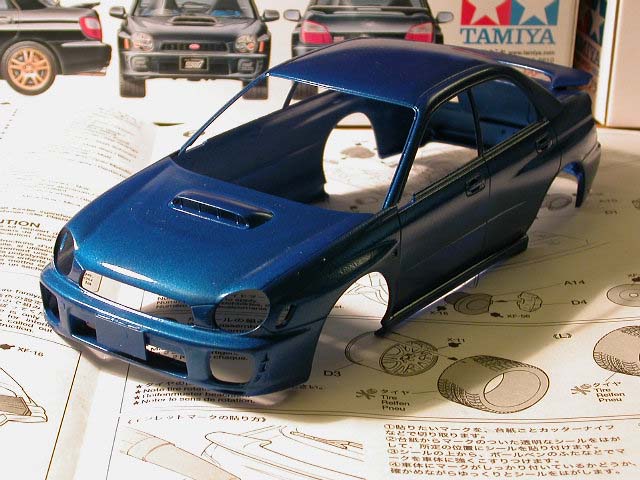

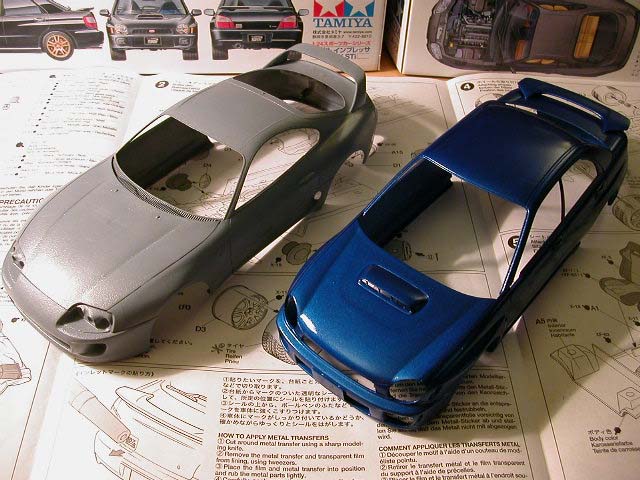

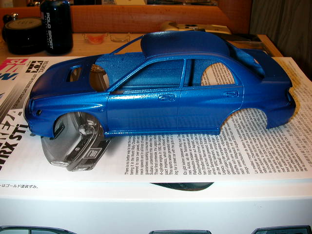

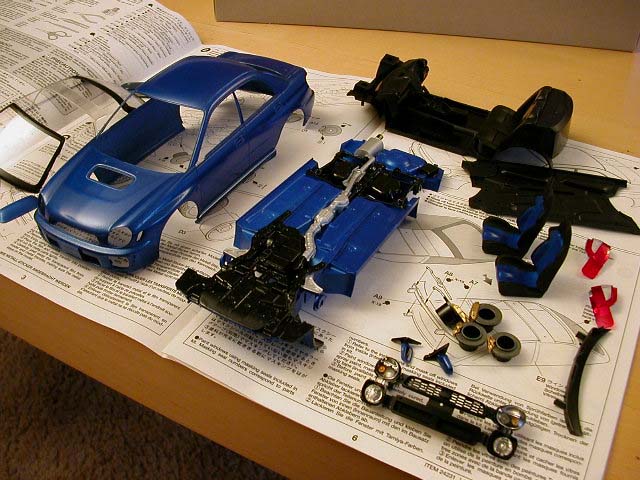

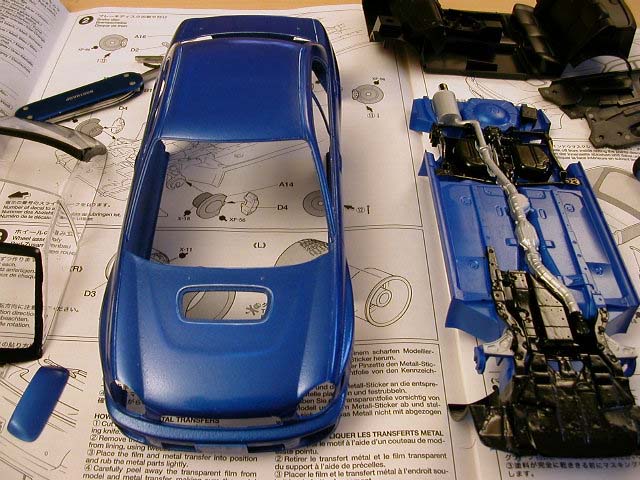

been quite busy for the last couple of weeks.. finally getting to start my WRX project up again... here are some progress pics..

njh
03-27-2003, 04:49 AM
Looks good,
Could see that you have done some compund work on the body, but there still seem to have orange peel on it. Maybe you could sand it and respray it again?

kadler18
03-27-2003, 09:56 AM
Take the time to address the paint. The easy road of clearcoat will not solve the problem.
Wet sand the paint smooth. Wash and prep for painting. Spray two extremely light mist coats and one final wet coat. Let each of these three coat dry before application of the next coat.
That orange peel looks to be from the paint starting to dry and you were still putting a heavy coat on. - My guess?

Very clean looking! Hows the orange peel prob coming along? Did you polish it?
ssibangse
03-27-2003, 11:04 PM
it seems that ive had some problems with paint coming off due to too much rubbing with the tamiya compound.. so i've decided to sand my entire body down again and repaint the whole body.. i was out of TS-50 so i just placed a new order... hope it comes soon.. any tips on applying clear coat after the paint cures?

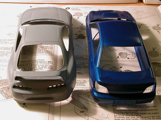

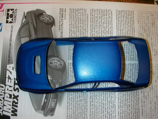

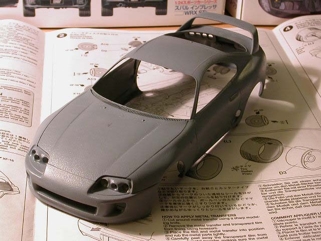

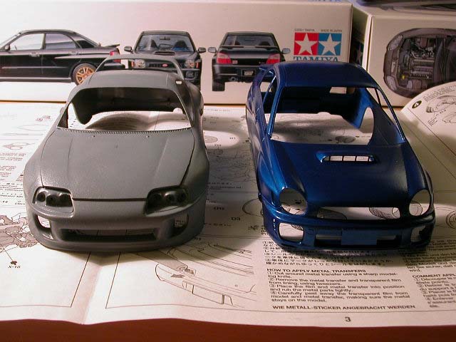

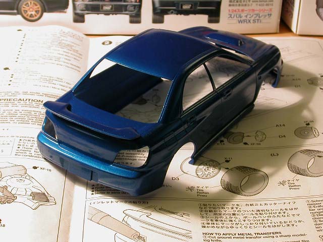

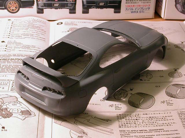

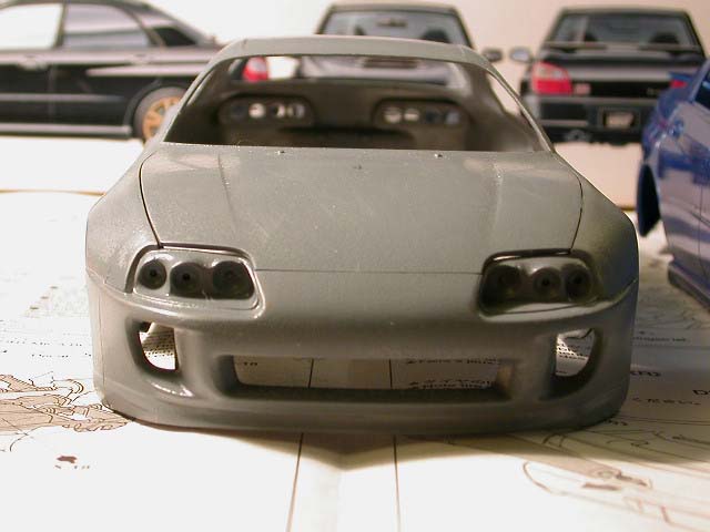

my package from HLJ arrived the other day and i was able to repaint my WRX... also started a Tamiya Supra as well... the supra's just been primered and the WRX still needs to be cut back and polished.

[S]ky|ine
04-04-2003, 06:57 AM
It looks better after you have polish your WRX!!! Sure it will looks even better after you polish again! The rest of the parts looks fine~:D

Damn good work of getting it more shinier than before!

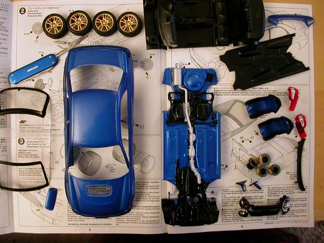

ssibangse
04-04-2003, 02:56 PM

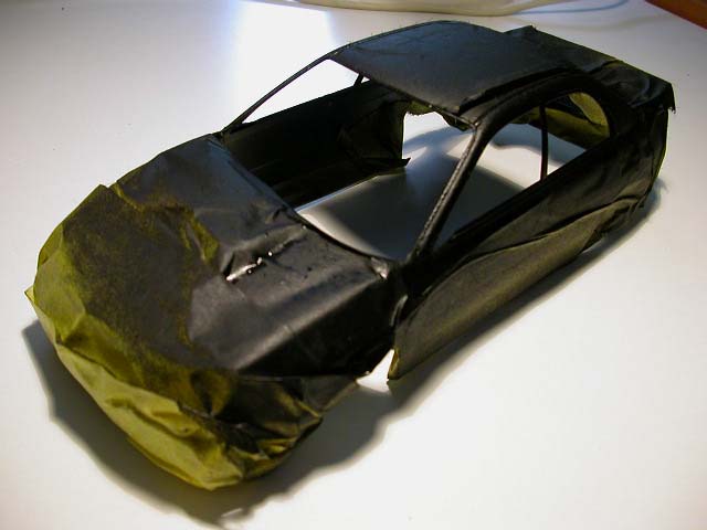

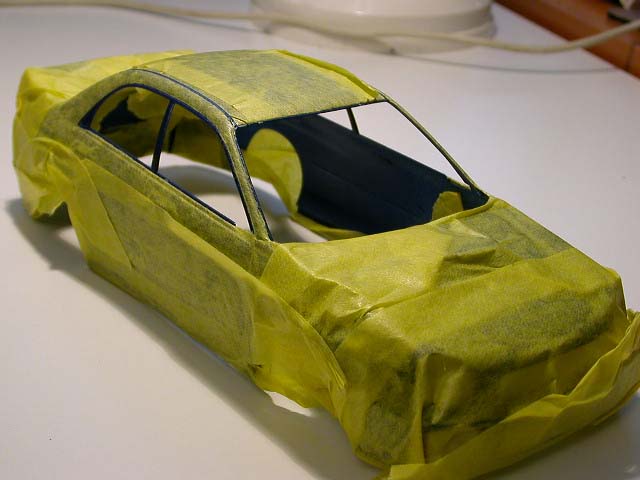

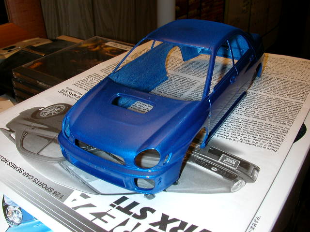

masking and painting with TS-6 Matt Black...

Blowncivic1320
04-04-2003, 03:40 PM
Looks like you have quite an orangepeel problem...that supra even looks like the primer has major orangepeel on it
D[X]P
04-04-2003, 05:14 PM
looms great but dont u think that u couldhave just used a brush for the pannel lines?
