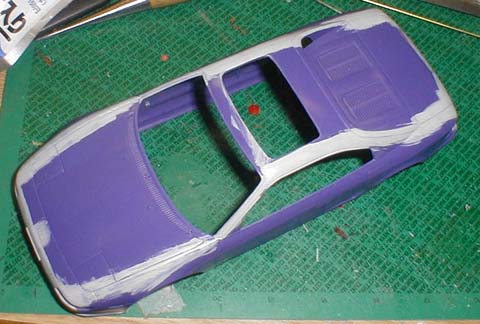

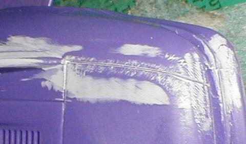

hirofkd
01-11-2003, 04:46 AM
Try using a file, instead of sand paper to reduce the gap. Then, coat the gap with superglue or putty, then sand it with 600, 1000 and 1500 grit.
Also, brush paint the primer (or Mr. Surfacer bottle) on the affected area to smooth the seam lines, instead of using a spray, or the primer will be too thick, and you'll lose the details.

thanks, I did not think of using the Mr. Surfacer bottle, I applied tamiya grey putty today and waiting it to dry.........I think I applied too much. Shit! I will try Mr. Surfacer bottle on my next project, it seems more precise.
