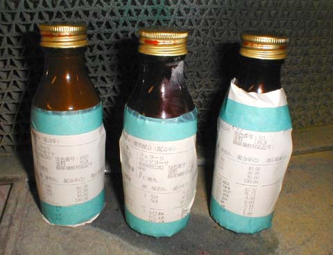

Today, I just got PPG paint I ordered a few days ago, and I'm very happy to have them.
They are Rosso Corsa, Rosso Fiorano Metallic and Giallo Modena.
The leveling speed of this urethane paint is very fast, and it dries quickly too.
I'll cover the tamiya paint with this urethane yellow as a final coat soon, and once it's done, I'll use 2 part urethane clear.
They came in 300 ml vitamin drink bottles. :)
http://files.automotiveforums.com/uploads/436289P2190002.JPG
The photo is poor, but they actually look realistic. One of my 360 kit will be in Rosso Fiorano.
http://files.automotiveforums.com/uploads/970488P2190005.JPG
