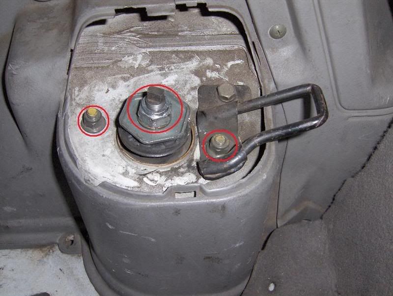

This is a view of your upper shock mount (rear driver side) beneath it's plastic cover. Be sure these are tight. The two smaller nuts hold the mount to the car, and the big, center nut holds the shock to the mount.

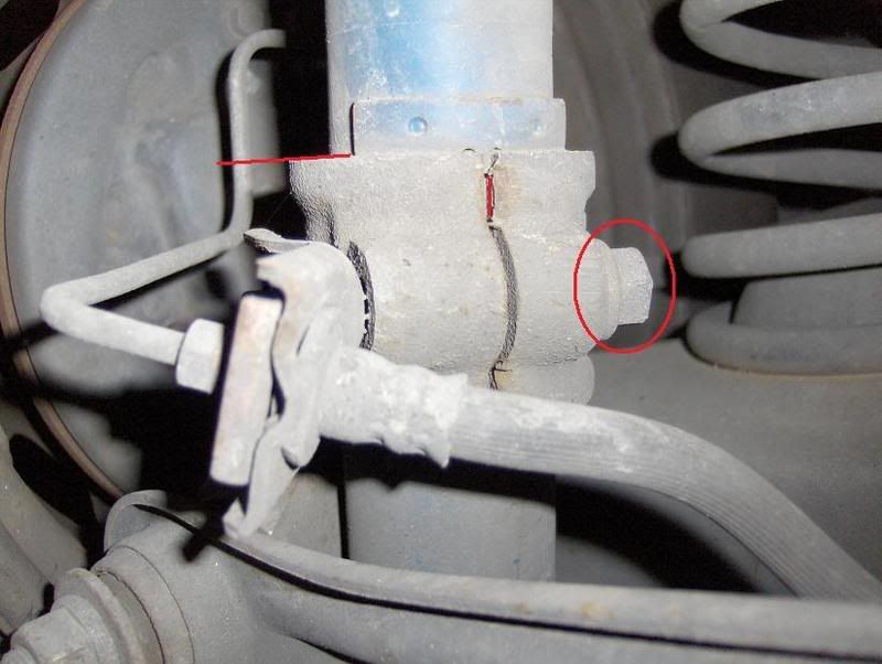

Below then is the bottom of the same shock. The lines are to point out the indexing tab that is attached to the body of the shock. This metal tab tells you when the shock is installed properly. Finaly make sure the bottom shock bolt is tight.
http://i77.photobucket.com/albums/j64/isc20/022.jpg
Grab the shock from underneath and give it a good push/pull. Do the same for the other side and the front.
