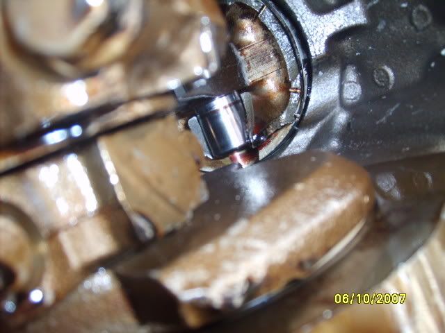

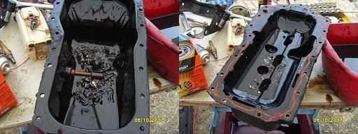

Here is what can result after long term usage....Not saying it will...But why risk losing a piston?
http://i162.photobucket.com/albums/t262/eippermx/cylinder4.jpg
http://i162.photobucket.com/albums/t262/eippermx/panjunksmall.jpg

Running the GTP on 87 octane is not a good idea. The PCM is supposed to retard the timing anytime it senses knock thus reducing the possibility of engine damage. In an emergency it is alright but a long term diet is not a good idea.
If you like to use the supercharger I recommend the premium. I realize it is expensive to purchase but given the alternative, as shown above, it is a lot cheaper than replacing the engine.

I've had my 2000 GTP since new, run regular unleaded all the time.. I'll run a tank full of premium once in a while when I plan on putting some miles on it with a good ole haul a$$ thrown in. But everyone is right, if you are going to use your boost, you need the octane. I have a busted piston in my shop to prove it.

On the other end of the spectrum, still on regular unleaded. Going up I17 from Phoenix to Flagstaff, 115mph, foot buried, uphill at about 4,000 feet elevation. Check engine light came on, lost power for a sec, then the engine was knocking. Limped it back to Albuquerque with the knock and pulled the head... That's the piston in my shop... LOL
