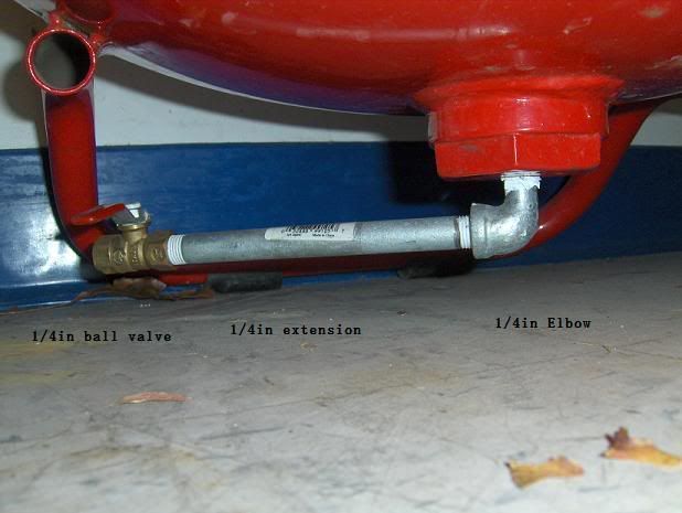

IOW - you can't go wrong. The price is right, and by the looks of them, Kobalt makes a sound piece of equipment. Take after me (and many other wise compressor operators) and install a ball valve at the bottom for easy draining after each use. DO NOT leave air in the tank overnight, for days, for weeks on end etc. I'll take pictures of my simple arrangement of parts I picked up from lowes. Follow the manual for break-in and oil change intervals and you should get decades of operation. Periodically check that the pressure relief valve releases air as it should. And never use extension cords with your compressor - it WILL shorten it's life.

91Caprice9c1
12-13-2007, 01:46 AM
http://i77.photobucket.com/albums/j64/isc20/002.jpg
Real simple. Much easier than reaching under and twisting the petcock every time you drain, just kick it and forget it. Thread pitch is NPT of course, so you wont have to worry about thread pitch. Use teflon tape, and that's all there is to it. Definitely one of my favorite compressor mods.
