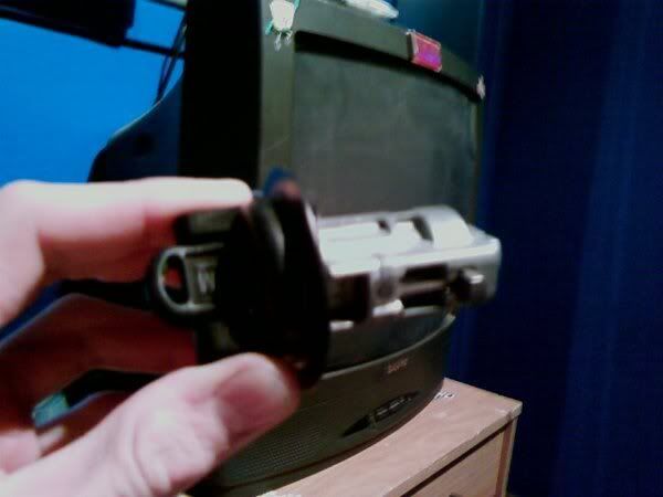

Oh Derk, this happened to me this spring, driving fine, went into McDonalds, bam same problem. Had to have it towed home, windows stuck down, they are power, couldnt turn key to put them up, its your lock cylinder. 2 days after I got it a replacement, you take off the plastic cloumn cover and follow the lock cylinder and you will see a little metal button dealy, problem is, the only way to push it in to unlock the cylinder to pull it out, is to be able to turn the key, SO what I did and works likea charm, get a really really thin flathead screwdriver, and ram in itand wedge the button out, its only in there by a cheap flimsy strip of metal holding it in......may take a little prying but it will pop out, and then you can pull the cylinder out! dont worry if you cant find the metal button that flies out, the cylinder is pooche anyways, heres a picture of it, the cylinder in the picture, is a spare I bought just incase this happened again, but hasnt, it will work for your car, as long as its 96+ and automatic. So if you need this, Give me a price and I can ship it out to you......comes with the original GM Key, I tested it personally turns like brand new. Hoope this helps, took me a while to figure this one out when it happened to me, guess it pays off when someone has the problem and cant figure it out. Hope this helps!
http://i35.photobucket.com/albums/d175/yhandor/derkkey.jpg

You can't get it out lol? It took me 5 minutes lol, you need a really really skinny flathead, long enough so the end goes right in there. once you get enoough force and pry it will fly right out. But lube didnt work for it? So that means you need to replace it.
yhandor
12-20-2007, 01:44 AM
Just keep prying and you will eventually get it.

You seriously cant get the pin pryed out Derk? Are you guys weak lol, it took me 5 minutes, I should have recorded it on video. its a really weak piece of metal holding the pin in and when you pry hard enough it will fly out...if I was near you I would do it for you, but Im in Canada lol.
