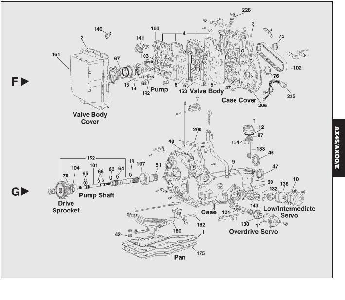

...IS THERE A CHAIN THAT DRIVES THE TRANNY? ...
I'm not sure what trans you have, but on the AXOD/E (or AX4S), there is a chain located under the case cover that drives the output. However, to get at it requires major disassembly. The chain is item 102 in the diagram.
http://i110.photobucket.com/albums/n113/rdh2/AX4Sbreakdown.jpg
The most probable causes are a stuck valve in the valve body or a bad transmission oil pump. I have seen several Taurus lately with bad pumps and pump shafts. The failures have been the pump shaft bearing in the valve body and worn pump vanes.
As Chevy Guy said, if you can remove a cooler line you can check pump flow. You could also connect a pressure gauge to check transmission line pressure.
