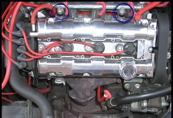

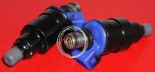

1. Are these the o-rings that you guys were talking about that needs to be replaced to prevent fuel leak? I'm assuming I just gently pry it off!?!

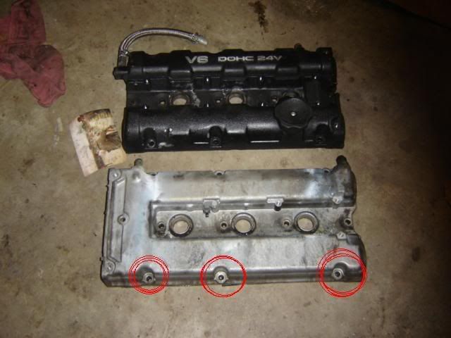

3. Also, below the injectors on the rear valve cover (between the injector and the VC), there seems to be some type of ring/seal...does/can that be replaced also? You can't really see it in this picture but it's there (it was too dark for me to take pictures tonight but I could take some if needed tomorrow):

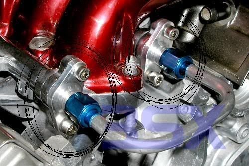

No they are talking about when you take off the fuel rail, right where it unscrews, on the inside, there are small rubber o-rings. When you take off the fuel rail, you will find them between the front fuel rail and where it connects to on both ends. They cannot be seen unless you have it taken off.

I was talking about the injector o-rings as well as the ones ^^ mentioned.

my orings somehow stayed in the fuel rail when I took off my injectors. Just used a coat hanger bent in a tinny U to reach up there and get it.

So wait, picture one and the rings on the "W" rail, right:

When you unbolt the w rail there will be two seals/o rings. Very easy to find and take out.
