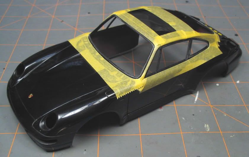

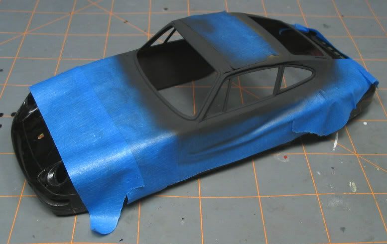

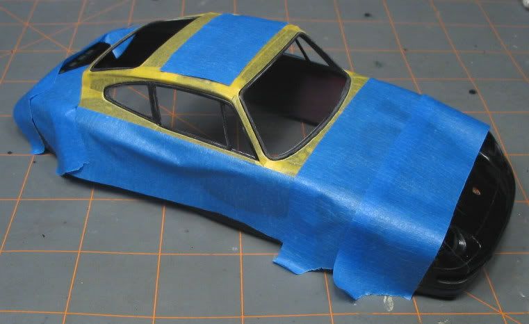

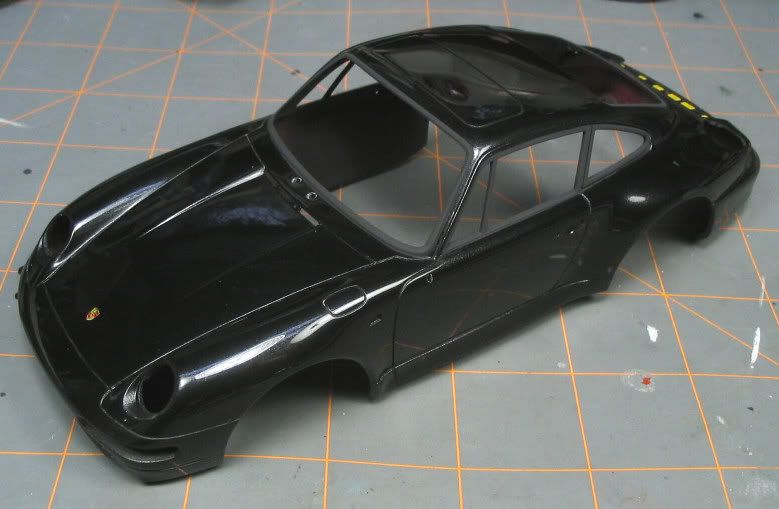

What exactly are you doing? What kind of paint for the trim, what kind of paint for the body, how are you applying the paint, and what problems are you having? We can't really help unless you give us details.
Here are some pics of how I go about it, as clearly as I can show it. There are descriptions to go with them in my Revell Porsche 993 thread (http://www.automotiveforums.com/vbulletin/showpost.php?p=4956895&postcount=40).
