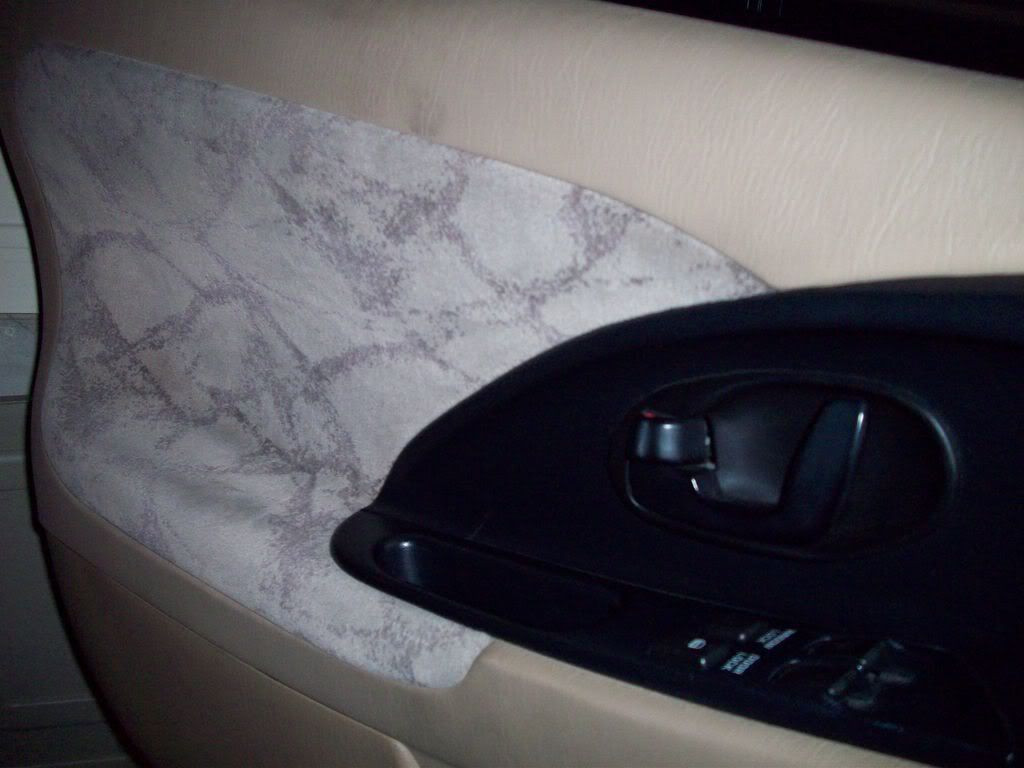

well all i wanna do is dye/paint this part of my door panel...
http://i186.photobucket.com/albums/x104/DSMtuner646/Interior/100_0063.jpg
http://i186.photobucket.com/albums/x104/DSMtuner646/Interior/100_0062.jpg
i wanna make it black because i do not like the "freaky sh*tty camo" design...

Is that like a felt material? In my car it was like a vinyl... If it is like a felt or cloth, then use the dye on that part...
