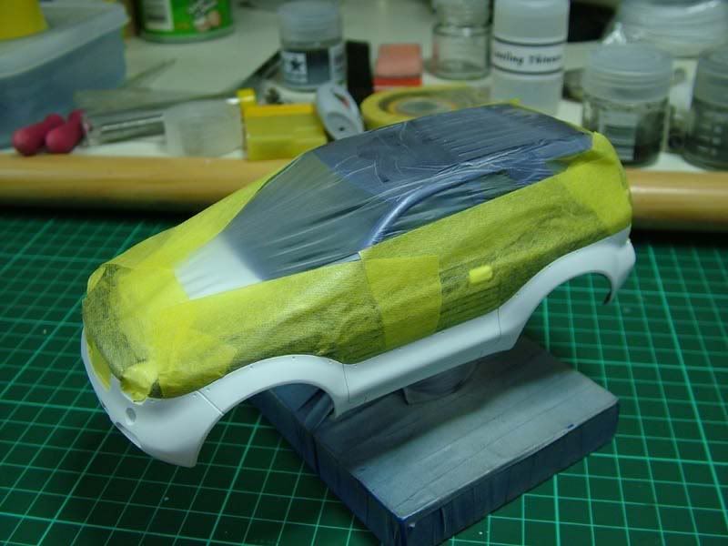

@all: I've tried Zero paints without a problem with it reacting. There IS one problem though... since I spray Zero paints at around 25-40 psi... the film is easily lifted.... I've also noticed that its not really good for masking up to a panel line.. So, I've done this:
http://i206.photobucket.com/albums/bb85/speedsnipe/Models/Vehi-Cross/28.jpg
Should have used thinner masking tape (I'm stingy :rolleyes:)... but still... everything went fine.
