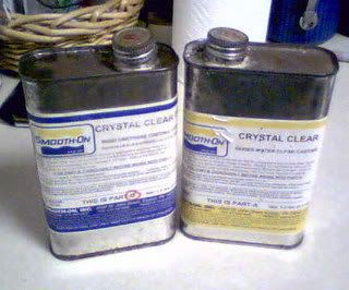

Lambo003
11-25-2007, 10:42 AM
I purchased it back in 2002 and it's still fine.
If anything it appears to be a little thicker but not really noticeable and sets up just as well as the day I bought it. It's still is quite thin.

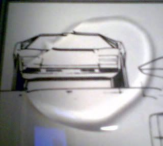

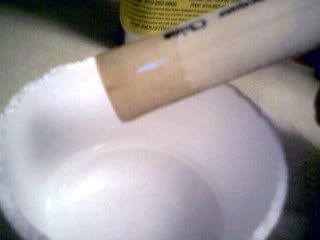

Here are a few pics. Dug it and out mixed up a batch . . .:wink:
Any yellowing is due to my camera and not the resin. It's literally crystal clear . .
http://i73.photobucket.com/albums/i213/Lambo63/resin3.jpg
http://i73.photobucket.com/albums/i213/Lambo63/resin5.jpg
http://i73.photobucket.com/albums/i213/Lambo63/resin4.jpg

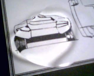

Then Poured onto a clear plastic sheet . . .
http://i73.photobucket.com/albums/i213/Lambo63/resin2.jpg
http://i73.photobucket.com/albums/i213/Lambo63/resin1.jpg

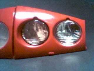

I was using it for replacements for Pocher Ferrari headlights.
The original headlights (seen in the left HL housing) were vac formed and then glued to a mylar "chromed" plastic sheet. Then a hole was drilled into the edge and resin shot in with a hypodermic applicator. Later after setting up the chrome mylar was trimmed away and the edges polished up.
http://i73.photobucket.com/albums/i213/Lambo63/L5.jpg
