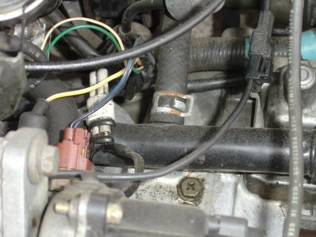

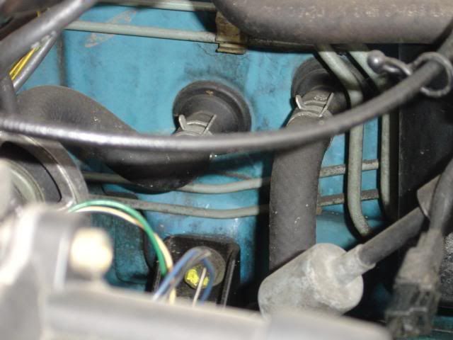

The Heater core itself is mounted Inside the car and Inside the Heater box BEHIND the dashboard. The 2 heater pipes that come from it just stick thru the firewall and attach to the 2 heater core hoses. The heater core hoses are the 2 Small heater Hoses at the Firewall....Open the hood, Stand on the DS (Driver Side) of the car and look down behind the engine. You'll see 1 Hose goes to the back of the Engine (Throttle Body Area) and the other hose goes into the Steel pipe that the larger heater hose from the radiator is hooked up too....Here 2 pics! With the engine COLD....Remove the heater hoses from the heater core itself or from the back of the TB and heater pipe (Still connected to the core pipes).......And flush away!....Your going too lose some Anti Freeze in this process....have some more on hand when you refill!
http://i25.photobucket.com/albums/c83/MrBBody/HeaterHoses1.jpg
http://i25.photobucket.com/albums/c83/MrBBody/HeaterHoses2.jpg

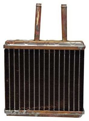

Geo Metro Heater Core - Approx 6" X 8" In size
http://i25.photobucket.com/albums/c83/MrBBody/GeoHeaterCore.jpg
