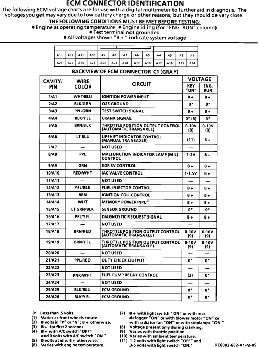

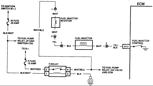

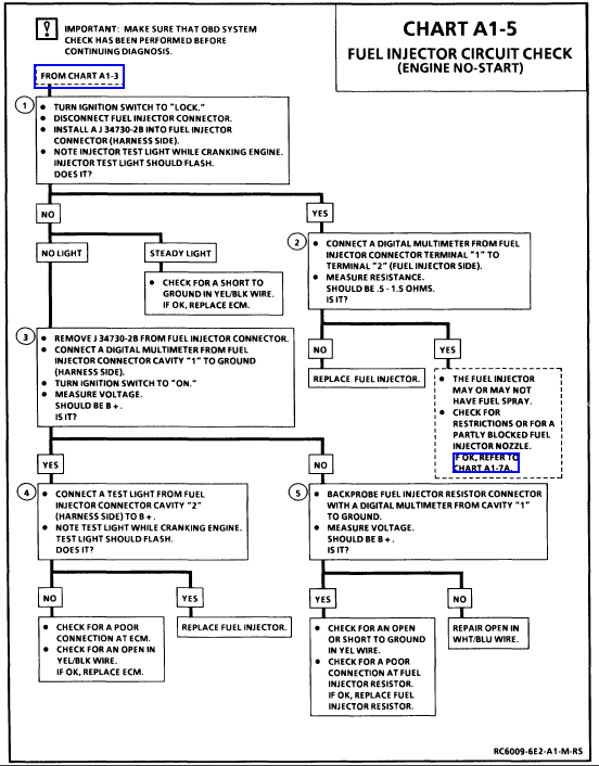

If your getting 12V at the yellow injector wire, And it sprays when you apply a ground signal to it, The fuel injector is driven by its solenoid coil based upon the ECM output signal. I Would trace back the Yellow /Black Stripe fuel injector wire....All the way to the ECM and inspect it for any damage or a poor connection at the ECM (Cavity A12), And also inspect the ECM Grounds to be clean and tight....If all looks good, Follow these flows charts for testing the FI system.
CIRCUIT DESCRIPTION
When the solenoid coil of the fuel injector is energized by the Engine Control Module (ECM) , it will activate the plunger and pressurized fuel will be injected into the Throttle Body Fuel Injection (TBI) unit. The fuel pump will operate as long as the engine is cranking, and the ECM is receiving ignition reference pulses. If the ECM does not receive any reference pulses, the fuel pump will stop after three seconds.
TEST DESCRIPTION
Numbers below refer to circled numbers on the diagnostic chart.
1. Checks to see if the ECM is controlling the fuel injector signals.
2. Checks the fuel injector for correct resistance.
3. Checks for voltage at fuel injector.
4. Checks for an open or short to ground in YEL/BLK wire, a faulty ECM or a faulty fuel injector.
5. Checks for an open or short to ground in YEL wire, an open in WHT/BLU wire or for a faulty fuel injector resistor.
DIAGNOSTIC AIDS
There may be fuel spray at the fuel injector, but it may not be enough to start the engine. If both the fuel injector and the circuit are OK, the fuel injector nozzle may be partly blocked.
http://i25.photobucket.com/albums/c83/MrBBody/FuelInjector1.gif
http://i25.photobucket.com/albums/c83/MrBBody/FuelInjector2.gif
http://i25.photobucket.com/albums/c83/MrBBody/ECMPlug.gif

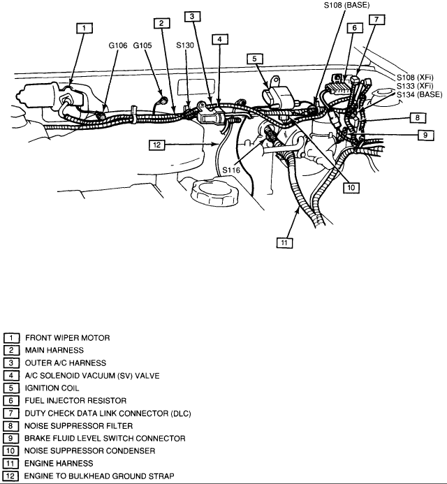

#6 Fuel Injector Resistor
http://i25.photobucket.com/albums/c83/MrBBody/FuelInjectorResistor.gif

Fuel injector resistance should be .5 to 1.5 ohms. Fuel injector resistor should be 1.9 to 2.1 ohms.
