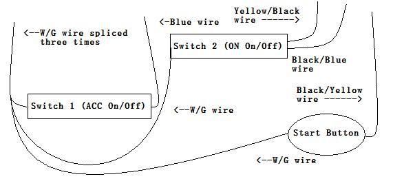

So what'll you need is equivelent gauge primary wire (looks like 10AWG), Two on/off switches and a push-button switch (normally off / push on) all rated for 30 AMPS @ 12VDC.
Here is a rough visual aid of what the wiring should look like:
http://i77.photobucket.com/albums/j64/isc20/Untitled-1.jpg
With the two switches and start button wired in parallel with the white/green wire.
When you start the car, turn on the ACC switch, then the ON switch, then push the start button to start the car (release after engine is running). When you shut the car off, turn off the ON switch, then the ACC switch.
Call me crazy but I think this might work. :icon16:
Disclaimer: It must be understood and accepted that this is an experimental tampering of the factory ignition system. I would not perform this procedure professionally for a customer for reaons of liability! I will not be held responsible for property damage or personal injury.
Having covered my rump, insulate your connections/splices well, disconnect the battery while hacking the system, keep a fire extinguisher handy, and be prepared to disconnect the battery for the first few trial runs.
Goodluck and post back!!

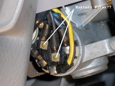

PS: Anyone have some information about these little black wires?
http://i77.photobucket.com/albums/j64/isc20/This.jpg
PPS: The two black wires and switch on the key side of the ignition are for the "chime" to tell you that you have a key in the ignition.

remuna
01-10-2009, 02:38 PM
I am currently doing the same thing to my 94 geo metro and am having the same problem with the two black wires. Did you ever find out what they are for and what to hook them up to?
