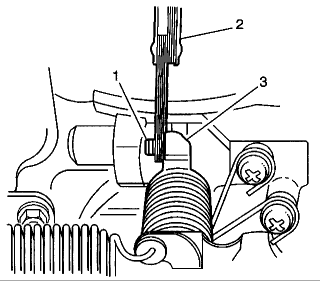

Check that the TPS is properly adjusted.
Insert a 3.5 mm (0.14 in.) feeler gage (2) between the throttle stop screw (1) and the throttle lever (3).

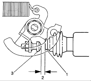

1) Inspect the idle speed control (ISC) motor plunger. If the ISC motor plunger (1) is contacting the throttle lever screw (3), then the engine must be brought to operating temperature. There must be no contact (2) between the ISC motor plunger and the throttle lever screw.

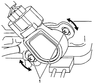

2) Back probe the throttle position (TP) sensor signal circuit at the powertrain control module electrical connector to ground.
Turn ON the ignition.
3) Observe the TP sensor voltage on the DMM. The TP sensor voltage reading should be 0.98 to 1.02 volts.
If the TP sensor voltage IS NOT 0.98 to 1.02 volts, loosen the TP sensor screws (1) and turn the TP sensor until the voltage reading is 0.98 to 1.02 volts.
http://i77.photobucket.com/albums/j64/isc20/86423805.gif
If a TP sensor voltage reading of 0.98 to 1.02 volts cannot be obtained, replace the TP sensor.

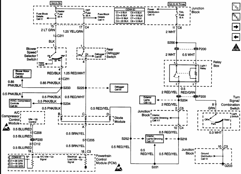

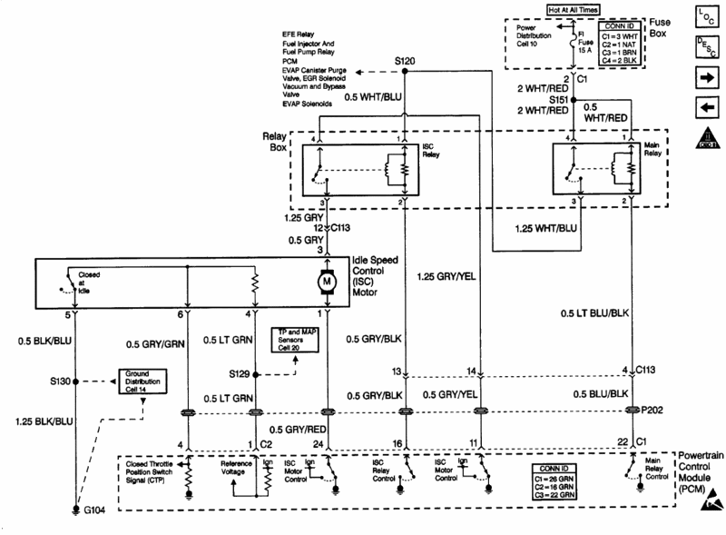

If you are good with a DIGITAL volt-ohm meter, here are the ISC and Idle-Up wiring diagrams.
ISC:
http://i77.photobucket.com/albums/j64/isc20/isc.gif
and Idle Up:
http://i77.photobucket.com/albums/j64/isc20/78725610.gif
If you'd like assistance with the ISC and Idle Up diagrams above, post back and we'll walk you through some circuit testing.
ISC:
and Idle Up:
