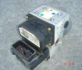

For those of you that do not know what an EBTCM (Electronic Brake and Traction Control) module is see pic below. Black modules. It is part of the ABS and traction control system and the electronic brain of the operation.
BTW - Funny you're the second member that mentioned and plugged Module Master in the last 90 days. :sly:
http://i5.photobucket.com/albums/y186/lizzywiz/ebtcm.jpg
ABS Pump with EBTCM module - (1999 and up Grand Prix with Bosch 5.3 ABS)
