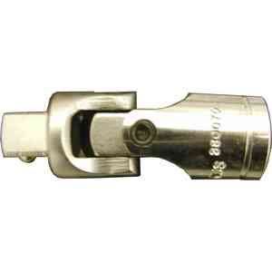

Specifically for this location, and for many other hard-to-attack bolt locations, one of these comes in very handy.
http://i77.photobucket.com/albums/j64/isc20/untitled.jpg
It's a 3/8" universal joint. In combination with a 3" long extension, and a 10mm hex socket, I use this trio by placing the oil pan bolt into the socket, then starting it in by hand with the extension. Once you are convinced it's not cross-threading on you, get your ratchet handle (or preferably torque wrench!) on it and snug it down. Torque spec. is 97 in.lbs.

Just wanted to thank everyone for providing me with helpful information. The 3/8" universal joint tool worked extremely well. I'm glad that it was mentioned as I used it in a spot that only one of my fingers would have fit in, which wouldn't have been enough to hand start the screw.
