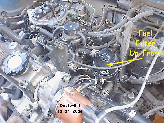

If and when you replace the Fuel Filter - why not bypass the filter under the car
by the tank with high pressure fuel line.
Then cut the line coming from the firewall to the Throttle Body in the engine
compartment and place the Fuel Filter up front where you can replace it with ease!
This has worked quite well for me!
The designer who put the Fuel Filter in that hideously inaccessible place tucked
in next to the Fuel Tank should be made to replace Fuel Filters in Hell for eternity!
http://i70.photobucket.com/albums/i86/DoctorBill_SCC/Metro%20Head%20Rebuild/Fuel-Filter.jpg
No problemo - now I can replace it in 5 minutes instead of hours under the car
with fuel splashing all over me.
Gasoline tastes bad, burns the eyes and makes you stink!
And makes you Oh so Flammable and possibly incandescent !
No smoking within 25 feet of the Fuel Tank or any open window or vent....
