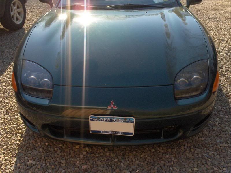

Also, here's the "robo" mod I did to mine:
http://i89.photobucket.com/albums/k226/X2Xtreme360/exterior001.jpg
