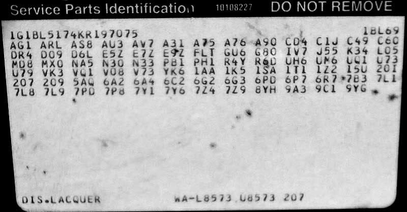

I've got an open diff on my '87 and want a posi. I found a '87-90 (not sure which year exactly) with what I believe is a posi at the local junkyard. Is there any difference between these rear ends other than the gears? What I'm wondering is if I should even bother getting the whole rear end from this posi car and having it checked over and possibly rebuilt or should I just have my current open diff rebuilt and converted.
edit- Also, the codes in the trunk are GU6 and G80. Was I correctly informed G80 means posi? Anybody know the ratio of GU6? And I know you can tell if it's posi by spinning 1 wheel when the car's in the air and if they both turn the same way it's posi or open I don't remember, and if they turn opposite directions it the opposite, whichever that is I don't remember. Need some clarification, thanks!
edit- Also how do I tell if it's got the beefier springs I want?

The above car is a 1990. 10th digit in VIN = K. K = 1990.
G80 = posi
GU6 = 3.42:1
Want beefier springs? Go get a set of 'heavy duty' springs at Autozone. These correspond with the 9C1 "RJ" springs which are stiff. They'll be better than any worn-out junkyard springs. That's one thing I don't like to use from a junkyard - springs.
