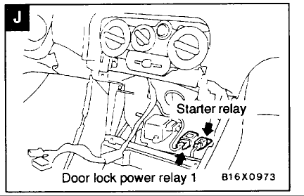

The car starts fine if you jump the car from the battery to the starter but by turning the key and pressing clutch I get nothing. its a 95 GSX, It has a new starter,new battery, and new cables. I think it is either clutch start switch or starter relay. I can check the clutch start switch by just unplugging it but what about the starter relay where is it on this car. :rolleyes:

Behind the radio I believe

It is behind the radio. There should be 2 relays back there, the one on the left is for the door locks and the right one is the starter relay.

It is behind the radio. There should be 2 relays back there, the one on the left is for the door locks and the right one is the starter relay. nop alredy cheked it but ok now that you tell me that which one is it, the small one or the big one? because i have the small one on the left and there is where i actually jump it to start the car

Its should be on the right side. But looks like its the smaller relay.

My relays are backwards the starter relay(smaller relay) is on the left and door lock on the right, I put a new starter relay in and it still does not start. If I take out the relay and take the top left terminal of the connector and bridge it to the bottom right terminal it will start with the key but by putting the new relay in, it won't start. Is there something Im missing or forgetting to do? So now I have a new Starter, new battery, new cables and new relay, but still no starting!!!
